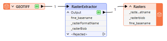

The raster feature is routed into a RasterExtractor, and then on to a Microsoft SQL Server Non-Spatial Writer.

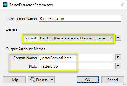

In the parameters dialog, Format is set to GeoTiff, and the Format Name and Blob attributes are left with the default names applied.

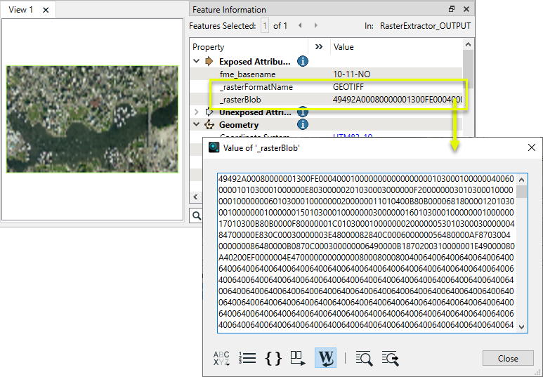

Examining the output from the RasterExtractor in the FME Data Inspector, note that the feature has two new attributes - _rasterBlob, containing the encoded raster, and _rasterFormatName, containing the name (GeoTIFF) of the chosen encoding.

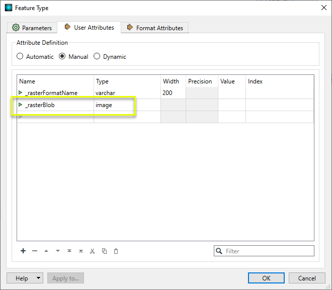

In the writer parameters, User Attributes, the Type of _rasterBlob is adjusted to Image, which is a binary field that supports larger values than varbinary, ensuring the data will not be truncated. (Note that the appropriate data type may vary between database formats.)
- This transformer may be used for writing raster data to a database field. Note that when writing the Raster Blob Attribute, you may need to adjust the attribute type to an unbounded data type to avoid truncation of the data. Choose an appropriate attribute type depending on the destination format (for example, an appropriate attribute type for SQL Server is 'image').

The raster format used to encode the blob. Choices include:
Format Name |
Name the attribute to contain the selected Format name. |
Blob |
Name the attribute to contain the encoded Blob. |
