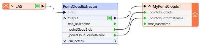

In this example, we will prepare and write a point cloud to a PostgreSQL database, which does not support geometry as an attribute type.
The point cloud feature is routed into a PointCloudExtractor, and then on to a PostgreSQL Writer.

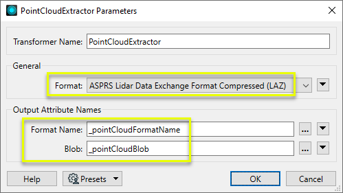

In the parameters dialog, Format is set to LAZ, and the Format Name and Blob attributes are left with the default names applied.

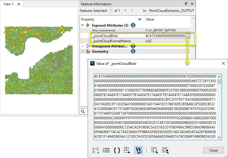

Examining the output from the PointCloudExtractor in the FME Data Inspector, note that the feature has two added attributes - _pointCloudBlob, containing the encoded point cloud, and _pointCloudFormatName, containing the name (LAZ) of the chosen encoding.

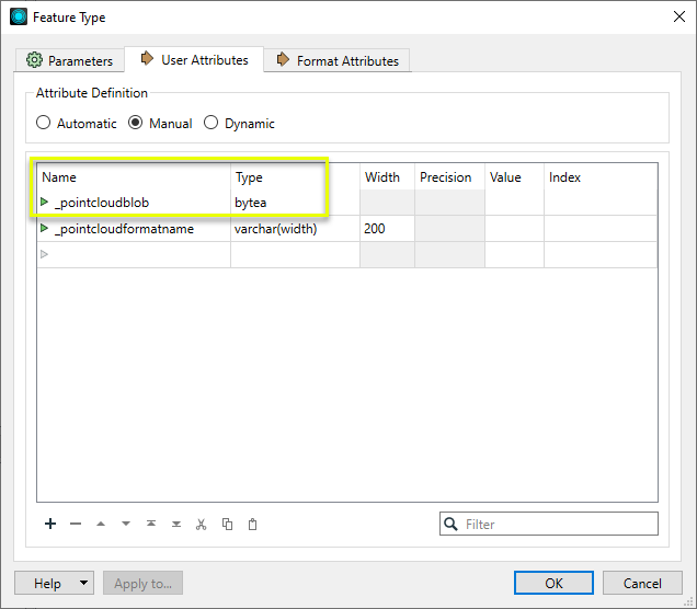

In the writer parameters, User Attributes, the Type of _pointCloudBlob is adjusted to bytea, which stores binary strings. (Note that the appropriate data type may vary between database formats.)
- When writing the point cloud Blob Attribute to a database, you may need to adjust the database User Attribute type to an unbounded data type to avoid truncation of the data. Choose an appropriate attribute type depending on the destination format.
