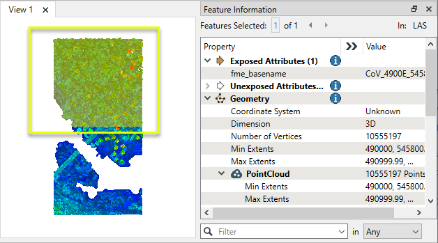

In this example, we will simply combine two point cloud features into one. Note the two input features are adjacent - and are in the same coordinate system.

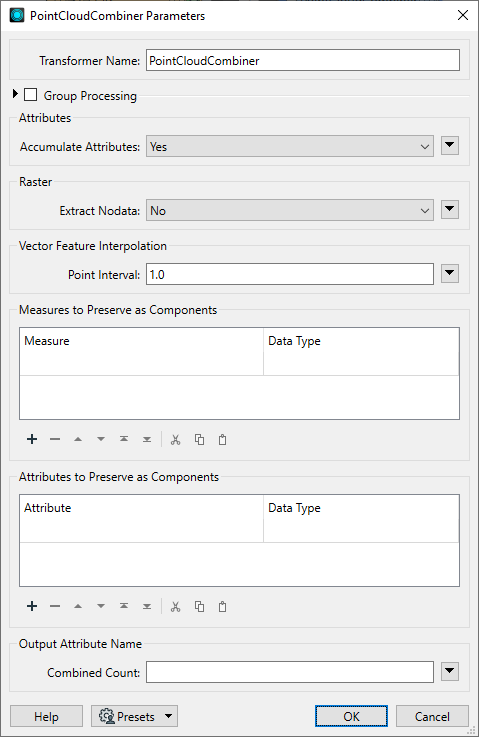

There are no parameters that need to be set for this basic operation - the default settings in the parameters dialog do not need to be changed.

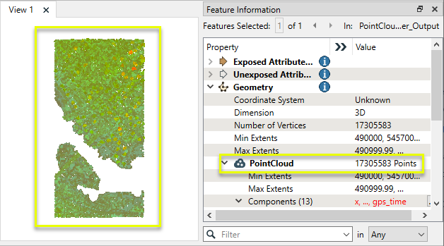

One point cloud feature is output. Note that the point count reflects all points from both input features.

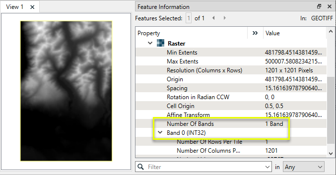

In this example, we will convert a digital elevation model (DEM) raster feature to a point cloud, so that it may be used with other point cloud data.
Note that the input raster has one numeric band, type INT32 (32-bit integer).

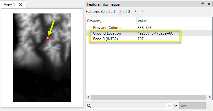

Each cell has x and y ground coordinates, and an elevation value stored in Band 0.

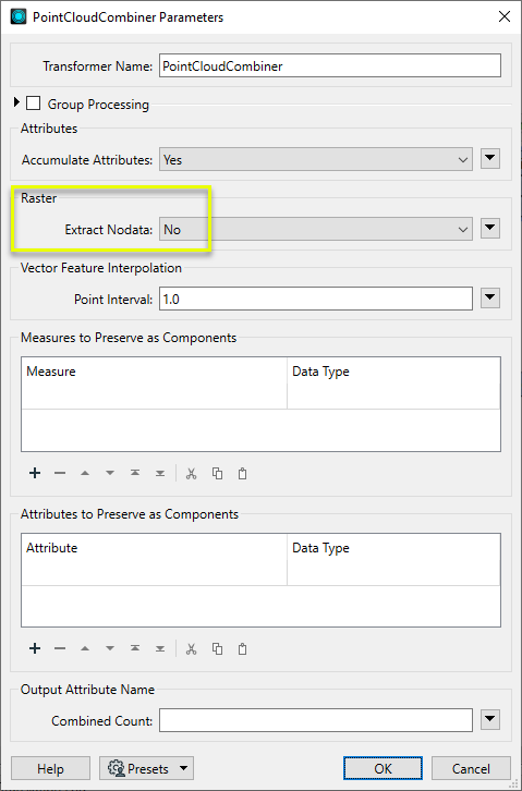

In the parameters dialog, the default settings are fine - including the Raster Parameters > Extract Nodata setting of No.

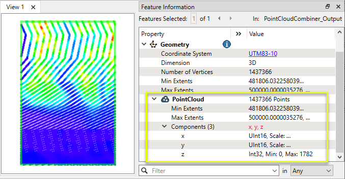

One point cloud feature is output, which contains one point for every cell in the input raster.

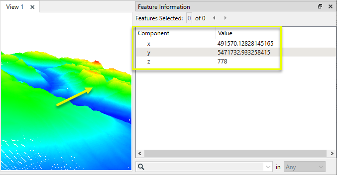

Each point has x and y component values from the original cell, and the z component contains elevation from the numeric raster band. The point cloud is viewed here at an oblique angle in 3D in the FME Data Inspector.
