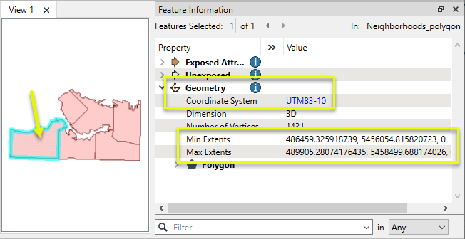

In this example, we have a set of neighborhood polygons. Note that the coordinate system is known, UTM83-10, and the extents are provided in meters.
We want to reproject them to geographic coordinates, latitude and longitude, WGS84.

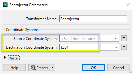

The features are routed into a Reprojector.
In the parameters dialog, we leave Source Coordinate System as its default, Read from geometry. The Destination Coordinate System is set to LL84.
The output features have been reprojected.
