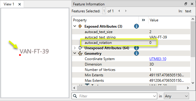

In this example, we have a CAD file containing traffic signal locations and labels. The original file is projected as UTM83-10, but we want to know what will happen to the label rotation if we reproject to BCPOLY-83.
Note that the label's autocad_rotation value is zero (0).

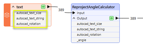

The features are routed into a ReprojectAngleCalculator.
Note that three format-specific attributes have been exposed - autocad_text_size, autocad_text_string, and autocad_rotation. This was done in the Autodesk AutoCAD DWG/DXF Reader parameters, Format Attributes, so that we can access their values.

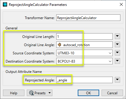

In the parameters dialog, we set Original Line Angle to the exposed autocad_rotation attribute, and the Original Line Length to 1 (meter, in ground units).
Both the Source and Destination Coordinate Systems are specified explicitly.
The Reprojected Angle attribute is named _angle (the default name).

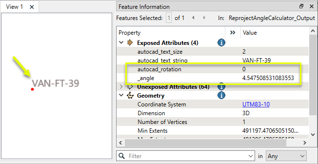

The output feature has a new attribute - _angle - with the value of the reprojected angle.
Note that the Coordinate System has not changed and is still UTM83-10. The feature itself has not been reprojected, its geometry not altered. The reprojection to BCPOLY-83 has only been used to calculate the _angle value.
