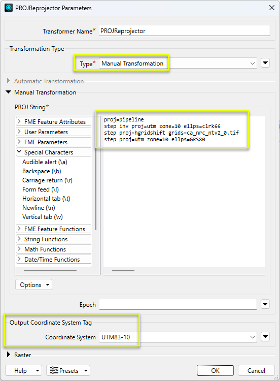

In this example, we have a shapefile of food cart vendors, with a UTM Zone 10 NAD27 coordinate system. We want to reproject this to NAD83, using PROJ.
The features are routed into a PROJReprojector.
In the parameters dialog, Transformation Type is set to Manual Transformation.
The required PROJ pipeline string is entered, which references both the source and destination coordinate system definitions and the desired grid shift file.

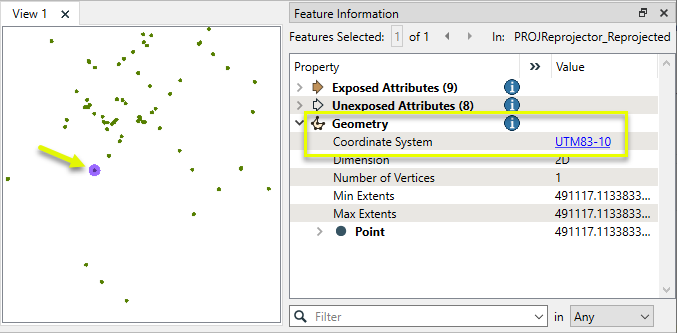

The Output Coordinate System Tag is set to UTM83-10, ensuring that FME can correctly identify the PROJ output.
The output features have been reprojected using the PROJ library, and FME can identify them as UTM83-10.

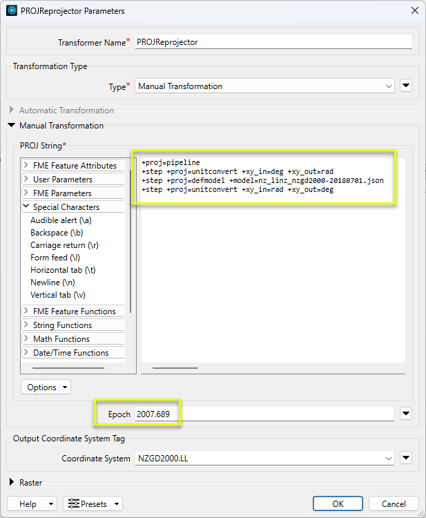

This example shows the PROJReprojector parameters configured to use an epoch with a PROJ pipeline.
Note that the desired deformation model is referenced in the pipeline string.
Epochs may also be provided via an attribute value or user parameter.

PROJ String |
When Transformation Type is Manual Transformation, specify a complete transformation in the form of a PROJ string (including multiple-step pipelines) or WKT2. For more information see Transformation pipelines at PROJ. Note that when reprojecting rasters or point clouds, the transformation specified here must be invertible. |
Epoch |
(Optional) Used for spatiotemporal transformations. Specify a decimal year that represents the time dimension to be used in the transformation pipeline. |
Coordinate System |
(Optional) Specify an FME coordinate system to tag the output features with. This will override the coordinate system selected by FME if an Automatic Transformation is being done. It is optional, but recommended that this parameter is always used when doing Manual Transformations to ensure FME handles the resulting features correctly during further processing. |
