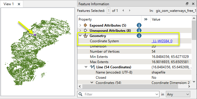

In this example, we have a shapefile of waterways in Sweden, extracted from OpenStreetMap. We want to reproject the features to an appropriate national coordinate system using the Gtrans engine.
Note that the source data is tagged as lat/long geographic coordinates, WGS84.

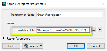

The features are routed into a GtransReprojector.

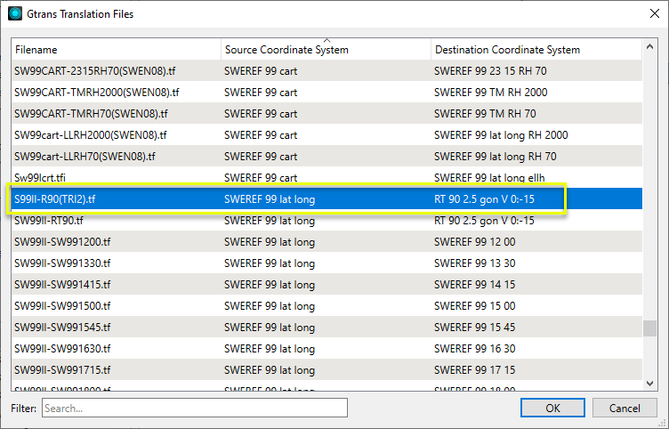

In the parameters dialog, a Translation File is selected.
The Translation File was selected from the Gtrans Translation Files gallery, via the ellipsis button. Note that the chosen Source Coordinate System is SWEREF 99 lat long, an equivalent to LL-WGS84.
