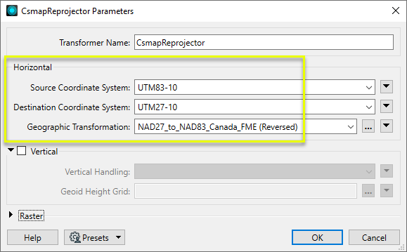

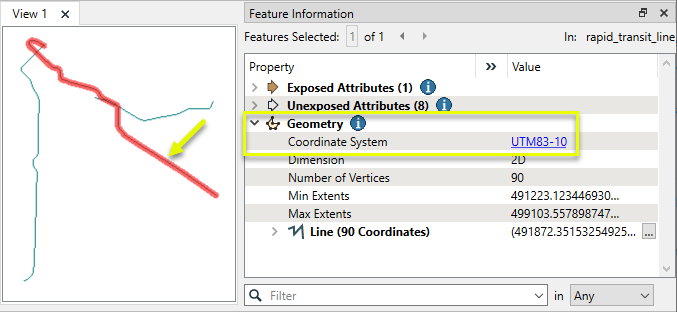

In this example, we have a shapefile of transit lines, projected in the coordinate system UTM83-10 - UTM Zone 10, NAD83 (North American Datum 1983).
We want to reproject them into an older datum - NAD27.
The features are routed into a CsmapReprojector.
In the parameters dialog, both the Source and Destination Coordinate Systems are explicitly defined.
Though we could leave the Source Coordinate System as <Read from geometry>, explicitly defining both of them gives us access to the available Geographic Transformations for that combination of coordinate systems. There are two, and we select the Canadian one for this dataset. Note that the direction is Reversed since we are going from the newer datum to the older one.
If we had previously set a preference in FME Options > Coordinate Systems > Implicit Transformations to either Canada Only or USA Only, the <Auto> Geographic Transformation option would use that setting.
The data is 2D, so Vertical Handling is not enabled.

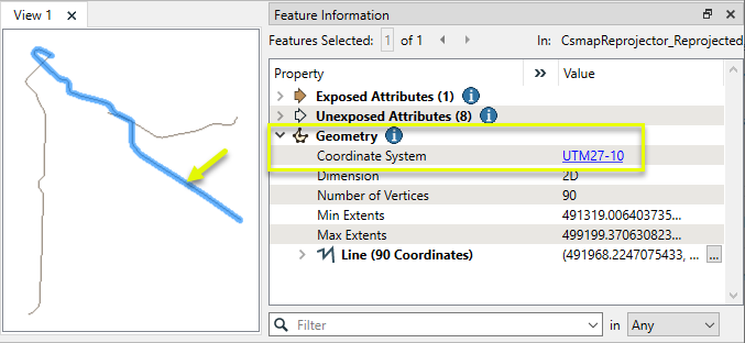

The output features are reprojected to UTM27-10.
Examining both the input (red) and output (blue) features overlaid in the FME Data Inspector (with the Background Map OFF), we can see the results of the datum shift, based on the Canadian NTv2 grid shift file.
