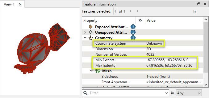

In this example, we have an OBJ file containing a 3D model of a public library. Note that the Coordinate System is Unknown, and that the extents would be appropriate coordinates for a local coordinate system.
We know what the local coordinate system should be, and so need to assign it without modifying the feature geometry.

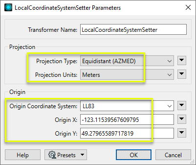

The feature is routed into a LocalCoordinateSystemSetter.
In the parameters dialog, we select a Projection Type of Equidistant (AZMED) and Projection Units of Meters.
Origin coordinates are entered as Lat/Long NAD83.

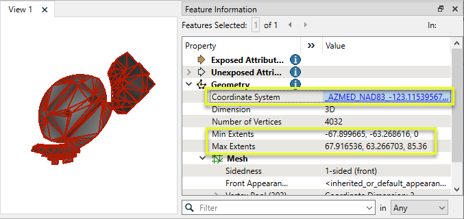

The output feature now knows its local coordinate system. Note that the extents are unchanged, as the feature’s coordinates have not been modified. .
