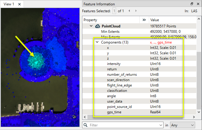

In this example, we will apply color to a LiDAR point cloud using an orthoimage. As seen here in the FME Data Inspector, the point cloud partially overlaps the underlying orthoimage - the point cloud coverage ends at the shoreline. This view shows an overhead (2D) view of both datasets, the point cloud overlaid on the raster.
Note that the point cloud has a number of standard components, but that does not include color.

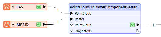

Both input features are routed into a PointCloudOnRasterComponentSetter - the point cloud (from LAS format) to the PointCloud input port, and the orthoimage (from MrSID format) to the Raster input port.

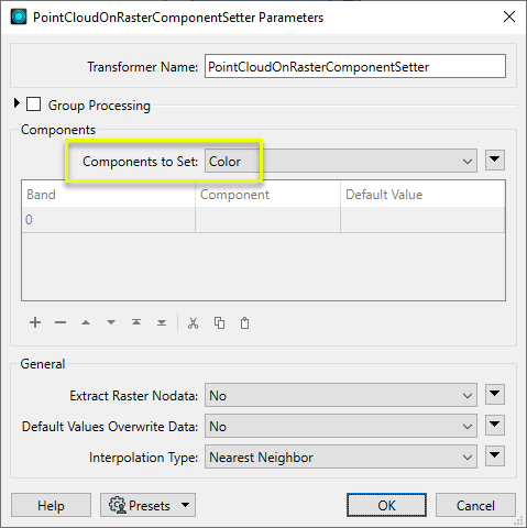

In the parameters dialog, we select the Components to Set as Color. Other parameters are left with their default settings.
The output point cloud now has color values in the color_red, color_green, and color_blue components.
