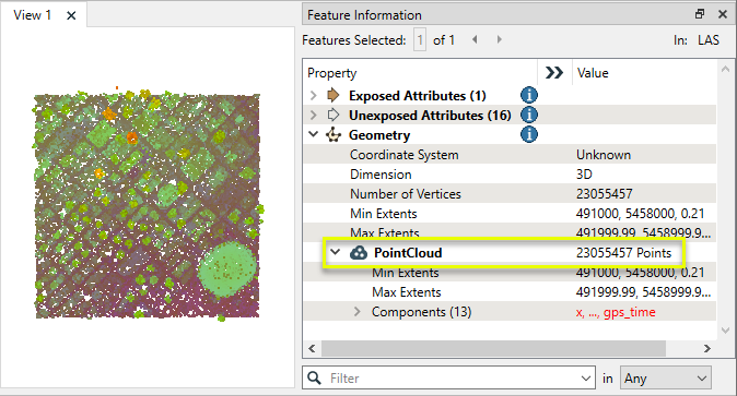

In this example, we will reduce the number of points in a point cloud. Note that the original dataset has over 23 million points.
The point cloud feature is routed into a PointCloudThinner.

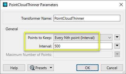

In the parameters dialog, Points to Keep is set to Every Nth point (Interval), and the Interval is set to 500.

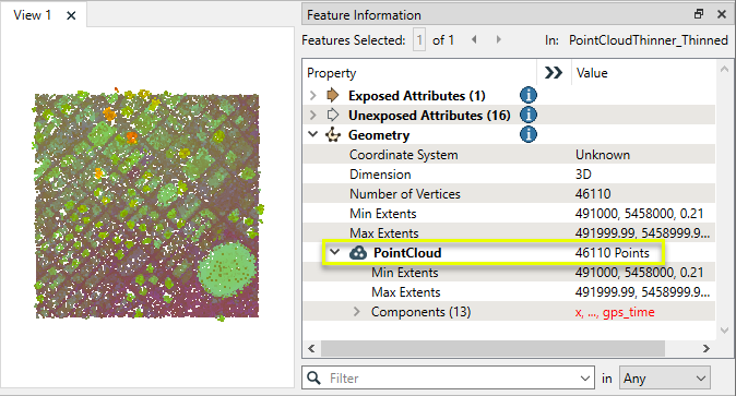

Every 500th point has been retained, and all other points discarded. The output feature has only 46,110 points.
