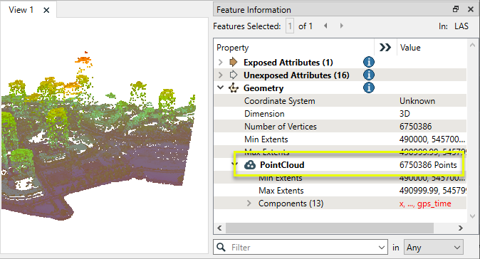

Note that the source dataset has over 6 million points in it. Viewed here in the FME Data Inspector at an oblique angle, we can see that it contains a number of tall structures in a fairly flat area.

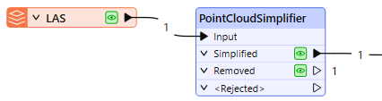

The point cloud feature is routed into a PointCloudSimplifier.

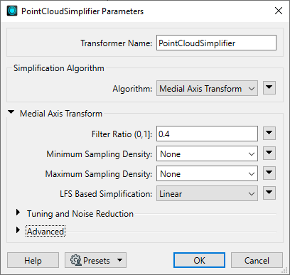

In the parameters dialog, the default settings are kept.

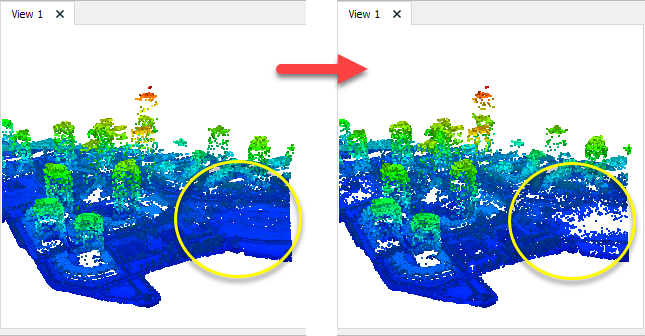

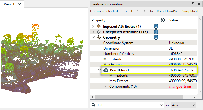

The output point cloud has been reduced to just over 1.6 million points. Note that areas with rapid elevation change - the structures - remain largely intact, whereas large flat areas with little change in elevation have been thinned much more aggressively.
Compare the point cloud before and after simplification:

Algorithm |
Medial Axis Transform: Perform simplification based on the Medial Axis Transform (MAT). This method estimates normals for each point and uses a ball-shrinking algorithm to approximate the MAT. Then it samples the point cloud based on each point’s Local Feature Size (LFS), defined by the shortest distance from the point to the medial axis. Points in areas of high curvature (low LFS) are sampled at a higher density than redundant low curvature (high LFS) points. |
Filter Ratio |
Specifies the desired level of simplification, relates LFS values to sampling density. Higher values will result in lower overall density. Typical values range from 0.01 to 0.8. |
Minimum Sampling Density |
Specifies the minimum sampling density for grid cells (in points per square unit). A value of 0 means that the sampling density is not bounded from below. This can be useful to maintain a minimum level of detail in nearly flat regions which would otherwise be removed entirely because of plane detection. |
Maximum Sampling Density |
Specifies the maximum sampling density for grid cells (in points per square unit). A value of 0 means that sampling density is not bounded from above. |
LFS Based Simplification |
Linear: Use the unmodified LFS values for each point during simplification. Quadratic (LFS^2): Use the square of the LFS value for each point during simplification. This will increase the effect that curvature has on point sampling. |
