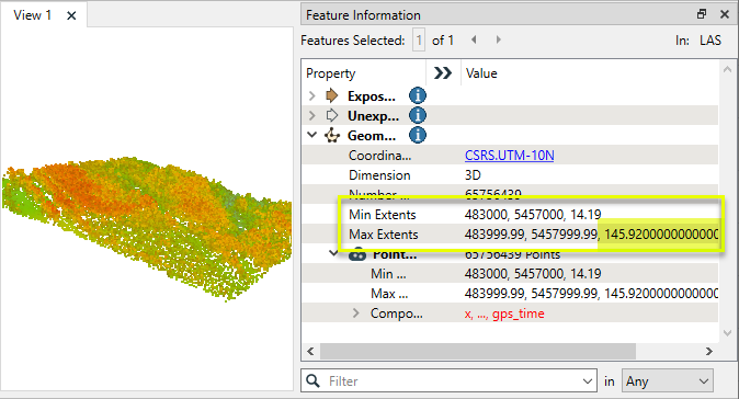

In this example, we will use point cloud sorting to identify the lowest points in a point cloud, removing vegetation to produce a bare earth representation of the area.
Note that the source point cloud is a heavily forested area, shown here from an oblique angle in the FME Data Inspector, and the highest point is 145.92 meters.

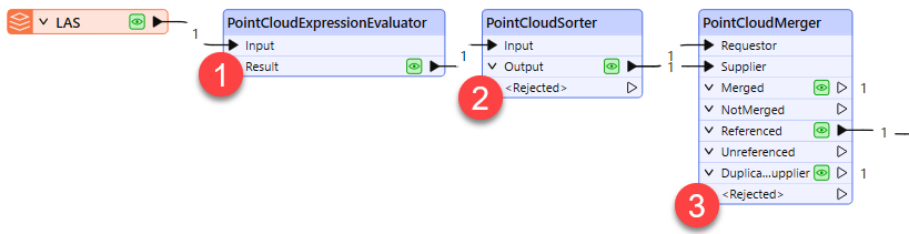

We will use three steps to find the lowest points:
- Round the x and y coordinates to a chosen grid size with a PointCloudExpressionEvaluator,
- Sort the points by elevation with a PointCloudSorter, in ascending order, so the lowest points occur first, and
- Merge the point cloud with itself to isolate the lowest point at each location, using a PointCloudMerger.

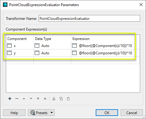

Step 1 - Round the coordinates
The point cloud is first routed into a PointCloudExpressionEvaluator. In the parameters dialog, the x and y components are recalculated, using an expression that rounds them to a specific interval - in this case, 10 meters.

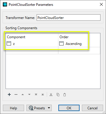

Step 2 - Sort the points by elevation
Next, the point cloud is sent to a PointCloudSorter. In the parameters dialog, we sort based on the z component, in Ascending order.

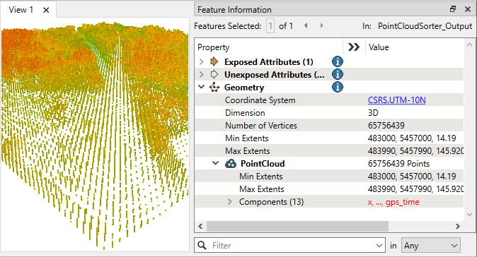

The result of these first two transformers is a point cloud that still contains all original points, but they have been shifted onto a regular xy grid with 10 meter spacing, and internally, the points occur in ascending order of elevation and so will subsequently be processed in that order.

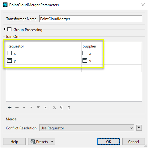

Step 3 - Isolate the lowest points
Next, the sorted point cloud is merged onto itself in a PointCloudMerger, routing a copy into both the Requestor and Supplier input ports.
The Referenced output port produces a point cloud containing the first occurrence of any given x,y pair. Since the lowest ones will be processed first due to the sorting, those are the points that will be kept.
(See the PointCloudMerger for a complete example of removing duplicates in a point cloud.)
In the parameters dialog, we join on the x and y components only - not z.

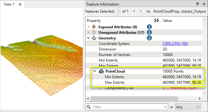

After sending the Referenced point cloud through a PointCloudPropertyExtractor (not shown in the workspace above) to calculate its new x, y, and z extents, we can see the bare earth representation as points spaced 10 meters apart, and with a new maximum elevation of 98.28 meters.
