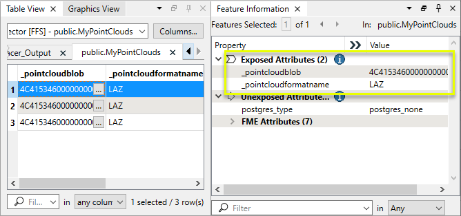

Examining a feature as it exits the database reader, note that it has no geometry.
The two attributes - _pointcloudblob and _pointcloudformatname - contain the encoded point cloud as a Blob, and the name of the encoding (LAZ) used for the point cloud. Both of these attributes were originally created by the PointCloudExtractor.

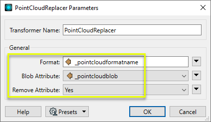

In the PointCloudReplacer’s parameters dialog, Format is set to read the contents of the _pointcloudformatname attribute. We could alternatively set it explicitly to LAZ, if we did not have an attribute providing that information.
Blob Attribute is set to _pointcloudblob, and Remove Attribute is set to Yes, which will remove the Blob attribute once it has been decoded and set as the feature’s geometry.

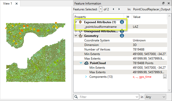

The output feature now has point cloud geometry, and the Blob attribute has been removed.
