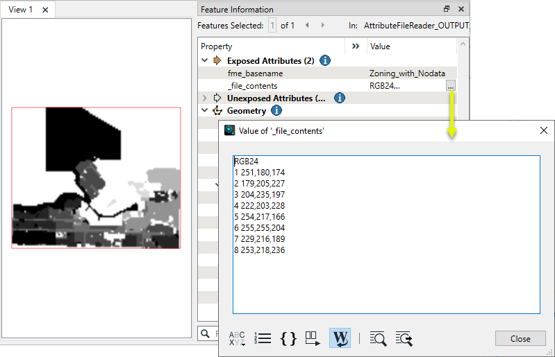

In this example, we will read a text file and add it to a raster feature as an attribute. We want to add a palette (the text file) to a numeric raster in GeoTIFF format.
The raster is first routed through a RasterBandInterpretationCoercer to meet processing requirements - the band type must be an unsigned integer to be compatible with palettes.
Next, the raster is passed to an AttributeFileReader. Note that it has one exposed attribute and consists of one numeric band, an 8-bit unsigned integer.
A text file containing the palette information has already been prepared, as shown here in Notepad.

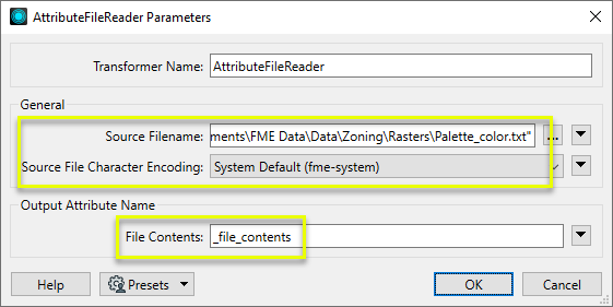

In the parameters dialog of the AttributeFileReader, we keep the default File Contents attribute name as_file_contents, and select the Palette_color.txt file.
As this is a text file, prepared on the same computer it is being processed on, we can use the System Default (fme-system) encoding.

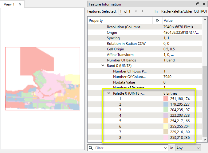

Examining the output from the AttributeFileReader, note that the raster now has an additional attribute, _file_contents, which contains the contents of the text file.
The last step in this workflow is to apply the palette from the new attribute with a RasterPaletteAdder.

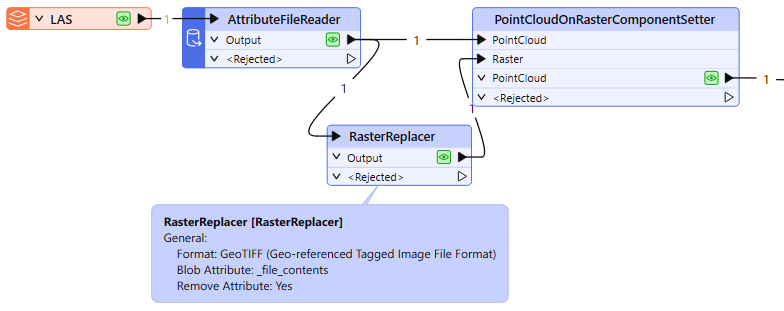

In this example, we have both a point cloud and an orthoimage of the same area, and want to keep them together - so we will attach the image to the point cloud feature as an attribute.

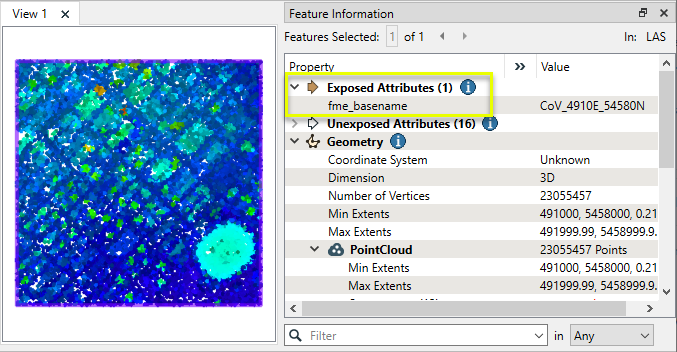

Note that the point cloud has one exposed attribute.

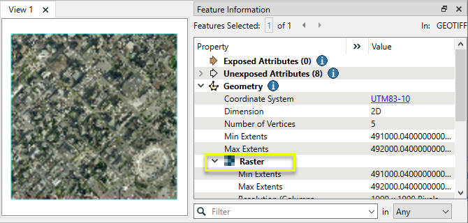

The orthoimage is a GeoTIFF.
The point cloud is routed into an AttributeFileReader.

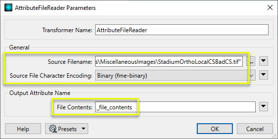

In the parameters dialog, we keep the default File Contents attribute name as_file_contents, and select the StadiumOrthoLowRes.tif file.
Source File Character Encoding is set to Binary (fme-binary), which will store the GeoTIFF as a Blob.

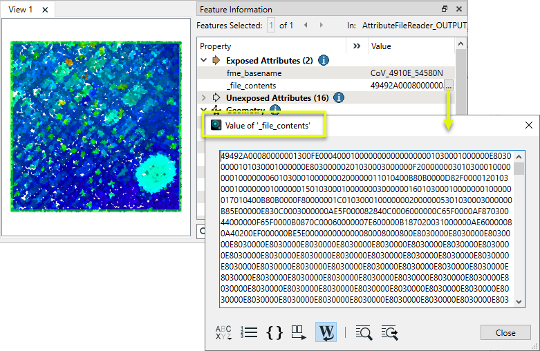

Examining the output in the FME Data Inspector, note that the point cloud has a new attribute which contains the orthoimage, still encoded in binary.
From here, the image can be decoded and used at any time with a RasterReplacer, as in the example below which would use the raster to color the points of the point cloud with a PointCloudOnRasterComponentSetter. Another subsequent use could be writing it to a Blob column in a database.
