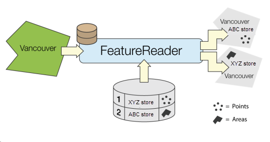

This transformer has two modes, depending on whether a connector is attached to the Initiator input port or not:
- Input-driven: When input features are connected, the transformer runs once for each feature it receives in the Initiator port.
- Run Once: When no input features are connected, the transformer runs one time.
When the Initiator input port is in use, the Initiator output port is also enabled.
Example
