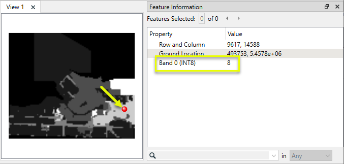

In this example, we will convert a single-band numeric raster to gray. The source raster is a GeoTIFF, with cell values ranging from 0 to 10, representing different land zoning. Note that the raster contains one band, and the interpretation type is INT8 - an 8-bit integer.
The FME Data Inspector knows the value range, and displays the cells as shades of gray, where 0 is black and 10 is white.

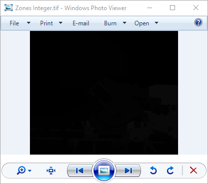

However, viewing the raster in another image viewer shows a nearly solid black image, because the values (maximum 10), when interpreted against a range of 0 to 255, are close to zero.
In order to use the raster for presentation purposes, it needs to be converted to a proper gray scale.

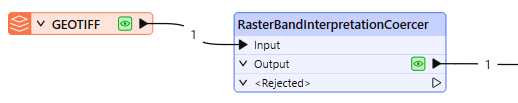

The raster is routed into a RasterBandInterpretationCoercer.

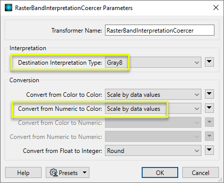

In the parameters dialog, we set the Destination Interpretation Type to Gray8. Three Conversion Options are enabled (as the transformer does not know what type of band will be received).
The important one for this translation is Convert from Numeric to Color. We choose Scale by data values, which will take the source range (0 to 10), and scale the values according to the destination type range (0 to 255).
The output raster feature contains a single band, and the Interpretation Type is now GRAY8. Note the cell value selected, previously 8, is now 204.
