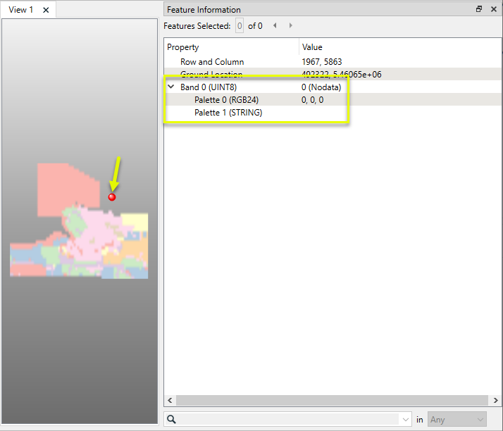

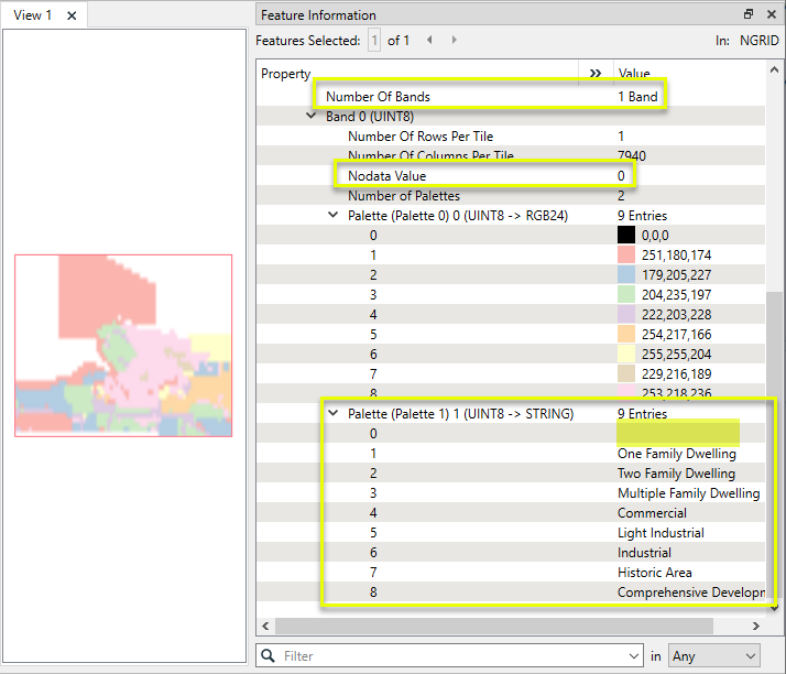

In this example, we have a raster with one band and two palettes. Palette 0 represents cell values as an RGB color, and palette 1 represents cell values as a text string. Note the following about the original raster:
- The Nodata Value on the band is zero (0)
- It has both an RGB24 palette and a string palette
- On the string palette, the key value zero (0) does not have an associated string value - it is blank.
We want to set a value on the string palette for Nodata.
Cells that fall within the rectangular boundaries of the raster but do not fall within a zone have a value of 0, and are considered Nodata. They are rendered transparently in the FME Data Inspector. In this particular area (Vancouver), they are generally water.

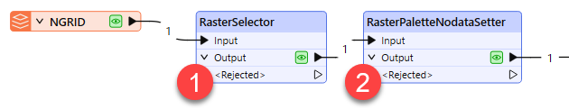

As the raster has more than one palette, two steps are required:
- Select the palette of interest.
- Set the value.

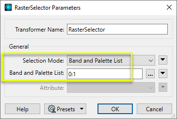

The raster is first routed into a RasterSelector transformer. In the parameters dialog, Selection Mode is set to Band and Palette List.
The Band and Palette List is 0 1, representing band 0 (the only band in this raster), palette 1 (the second palette, as numbering starts at 0).

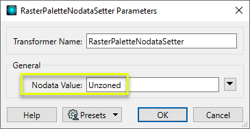

The next step is to set the value using a RasterPaletteNodataSetter. In the parameters dialog, we enter Unzoned as the new Nodata Value.

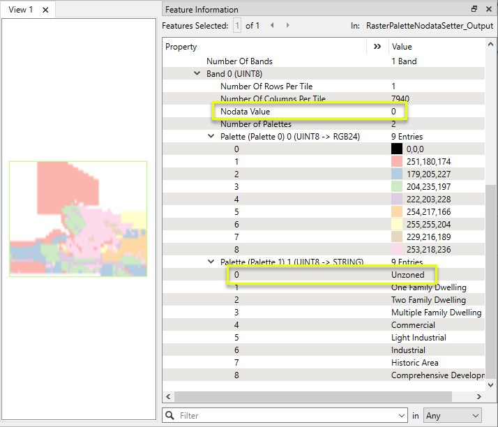

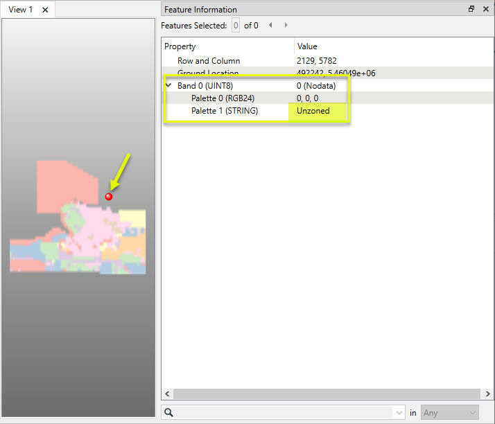

On the output raster feature, the value of palette key zero (0) on Palette 1 is now Unzoned.
Cell values in the Nodata region also reflect the new value.
