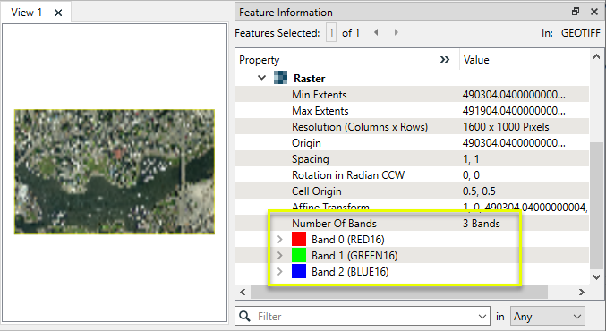

In this example, we want to reduce the bit depth and add an alpha band to our original raster, an RGB48 image that has three 16-bit bands - red, green, and blue.

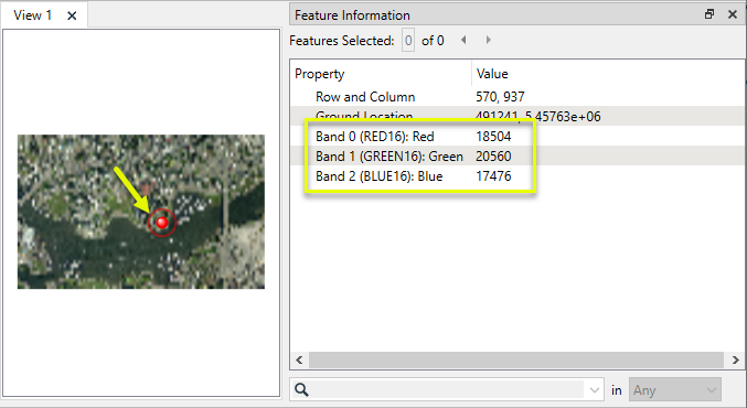

Note the individual cell values for the three bands, which fall in the range of 0 to 65535 (the possible values for a 16-bit band).

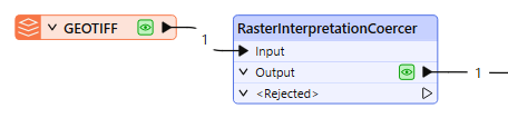

The raster is routed into a RasterInterpretationCoercer.

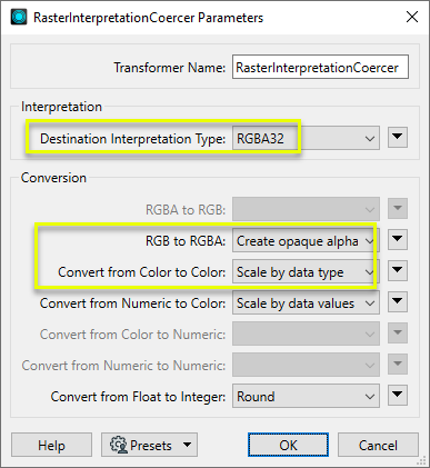

In the parameters dialog, we select a Destination Interpretation of RGBA32.
This choice enables a number of Conversion options. The transformer is not aware of what type of values it may need to convert, and so provides options for all variations - color, numeric, and float.
For our RGB input raster, the important ones are:
- RGB to RGBA: Create opaque alpha band. This will add an alpha band, and all cells in the band will have the maximum value for the selected bit depth - in this case, 255, as we are converting to 8-bit bands.
The input raster does not have Nodata values, and so we cannot create an alpha band from them. - Convert from Color to Color: Scale by data type. Values will be scaled according to the ranges of both the input and output rasters. As we are converting from 16-bit to 8-bit, this means that:
- 0 will become 0
- 65535 (the maximum 16-bit value) becomes 255 (the maximum 8-bit value)
- Values in between are scaled accordingly.

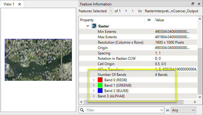

The output raster feature has four bands, including the new alpha band, and all are 8-bit.

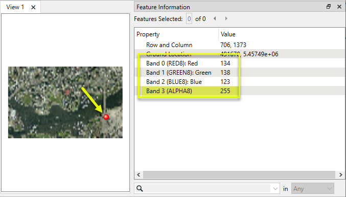

The individual cell values have been scaled, and the alpha values are set to 255 (fully opaque).
