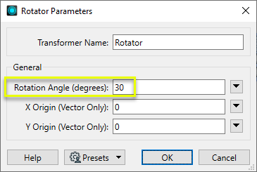

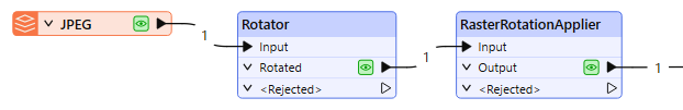

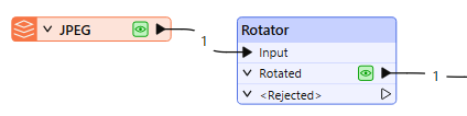

The raster is first routed into a Rotator.
In the parameters dialog, the Rotation Angle is set to 30 degrees.

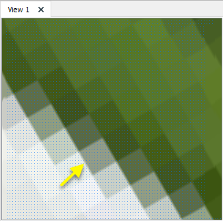

A rotation angle of 30 degrees is attached to the raster feature as a property. The FME Data Inspector interprets this new Rotation and displays the raster accordingly, rotating it around the upper left corner. The Rotation Angle has been converted from degrees to radians.
The rotated raster is shown here over the original. The rotation is a result of the display method - the raster itself has not been fundamentally altered, and the rotation could easily be changed or undone.
Note that the individual cells are shown at the rotated angle.

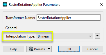

The raster is now routed into a RasterRotationApplier.
In the parameters dialog, Interpolation Type is set to Bilinear.

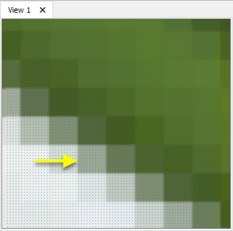

The output raster contains the rotated raster placed in a new raster, which has the dimensions of the minimum bounding rectangle of the rotated feature.
Cells outside the coverage of the original raster are given the value zero (0) on all bands, showing black. A RasterBandNodataSetter could be used to render them transparently.
The Rotation in Radian CCW of the new output raster feature is 0,0.
The cells have been reinterpreted, using the selected Interpolation Type, and are unrotated.
