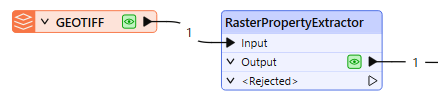

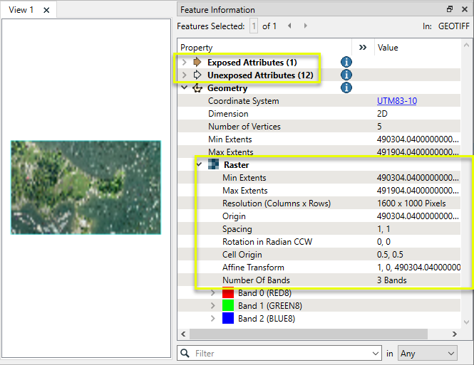

In this example, we will extract the geometry properties of an orthoimage. Note that the source raster feature has 13 typical attributes. Some geometry properties can be seen in the Feature Information window of the FME Data Inspector (under IFMERaster), but are not exposed in a usable attribute form.
The raster is routed into a RasterPropertyExtractor.

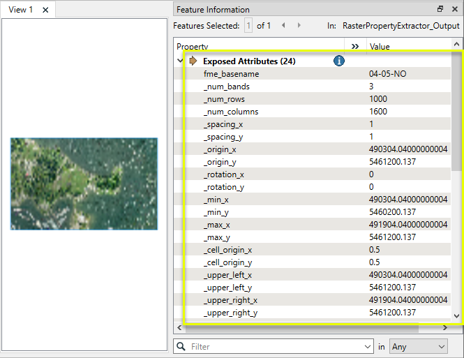

There are no parameter settings in this transformer. The raster is output, with new attributes exposed containing properties.
