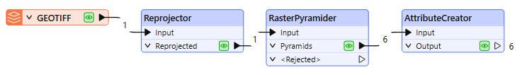

In this example, we are building a raster processing workspace.
The source dataset is a 2 Gb GeoTIFF raster, which needs to be reprojected, then pyramided, and then passed along for further processing.
As both of these operations will be accumulated until they are required (such as enter a writer), we cannot yet determine how long it might take to process this.
A run of the workspace as it stands is very fast, an indication that the two raster operations have been held for later processing.

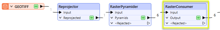

To get a more accurate idea of how long this will take, we add a RasterConsumer after the two raster processing transformers - the Reprojector and RasterPyramider.

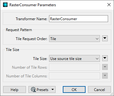

In the parameters dialog, we keep the default settings.
Running the workspace again, we can see that it will take significantly more time to fully read and process the rasters, with the accumulated operations applied.

Note that the default parameter settings are generally used.
Tile Request Order |
Tile (Default): The raster data is read one tile at a time until all tiles are consumed. Several bands may be read for a given tile. Band: The raster data is read one band at a time until all bands are consumed. |
Tile Size |
Use source tile size (Default): The default tile size reported by the band will be used when tiles or bands are consumed. Specify source tile size: The raster will be consumed using the specified Number of Tile Rows and Number of Tile Columns. |
Number of Tile Rows
In conjunction with Specify source tile size, specify the number of rows and columns. |
