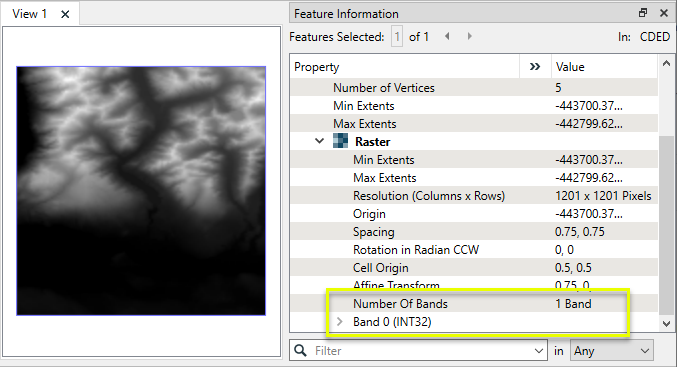

In this example, we will extract the minimum and maximum elevation values from a DEM raster. Note that the original raster feature has one band, containing elevation values in meters.

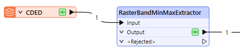

The raster is routed into a RasterBandMinMaxExtractor.

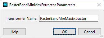

The transformer has no parameters to configure.
