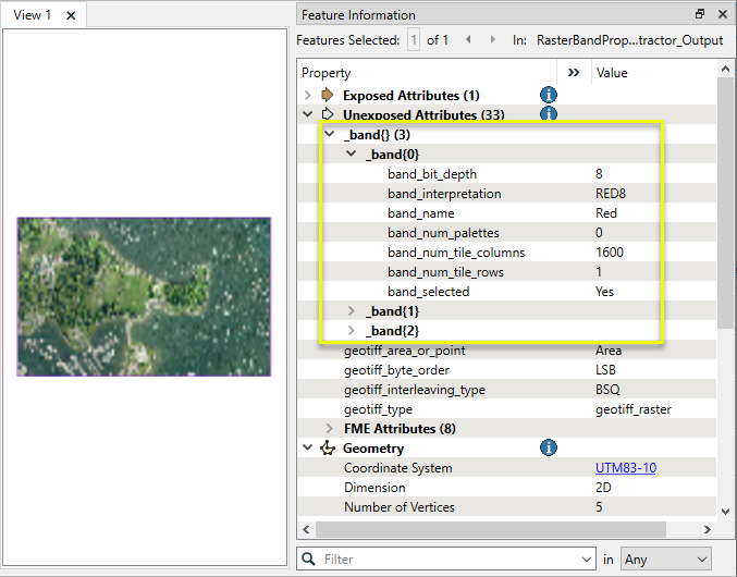

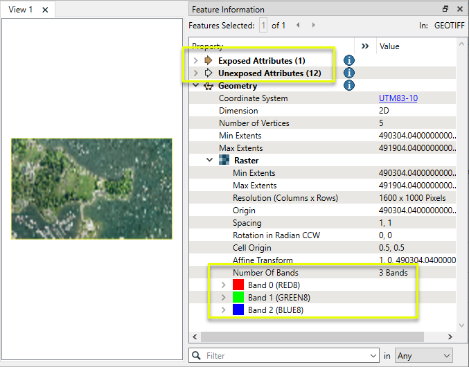

In this example, we will extract the band properties on an RGB orthoimage. Note that the source raster feature has a number of attributes, and 3 bands.

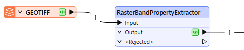

The raster is routed into a RasterBandPropertyExtractor.
There are no parameter settings in this transformer. The raster is output, with new list attributes added containing properties for each band.
