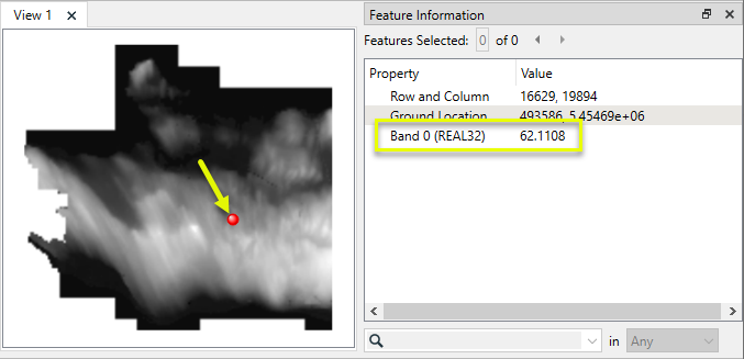

In this example, we will identify the range of elevation values less than 15 meters, and apply a single value (zero) to all cells that fall within that range, simulating a 15 meter sea level rise. The source data is a DEM in GeoTIFF format. Elevation is stored as the Band 0 value.

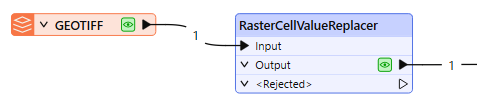

The DEM is routed into a RasterCellValueReplacer.

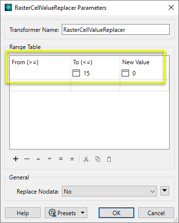

In the parameters dialog, we define a range of values less than or equal to 15. The new value is 0.
A raster feature is output, and all cells with elevations that fell within the range now have an elevation value of 0.
