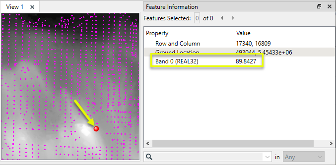

In this example, we will extract elevations from a DEM raster (in GEOTIFF format) for the points in a street intersections dataset. The points are shown here, overlaid on the raster. Note that one cell in the raster is selected and Band 0 contains the elevation value.

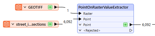

Both datasets are routed into a PointOnRasterValueExtractor.

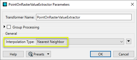

In the parameters dialog, the default Interpolation Type of Nearest Neighbor is kept.

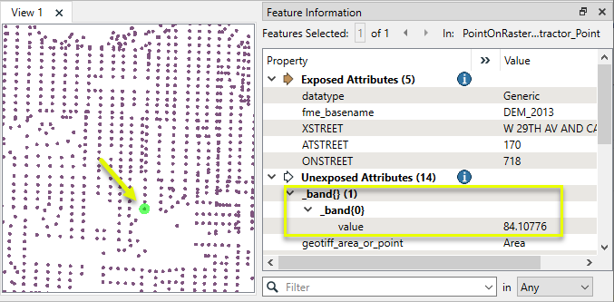

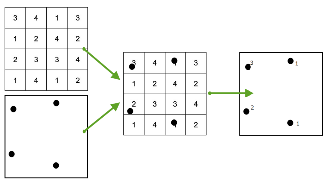

Point features are output with elevation values attached as a new list attribute, based on the Nearest Neighbor interpolation. This means the nearest cell center to the point feature provides the new attribute value. As the original raster has only one band, only one value is contained in the list.
