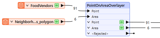

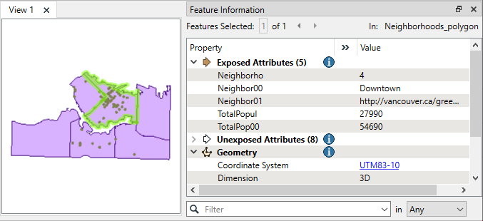

In this example, we have a point dataset of food vendors and a set of polygons representing neighborhoods.
To find which neighborhood a vendor is in, we connect the food vendor points to the Point input port, and the neighborhoods to the Area input port.

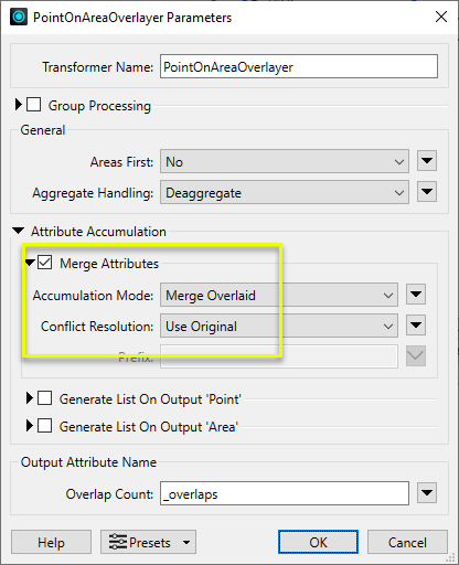

In the parameters dialog, the default settings will provide the correct results. Note that the Accumulation Mode is set to Merge Overlaid, which will add attributes from the containing neighborhood polygon to each point.

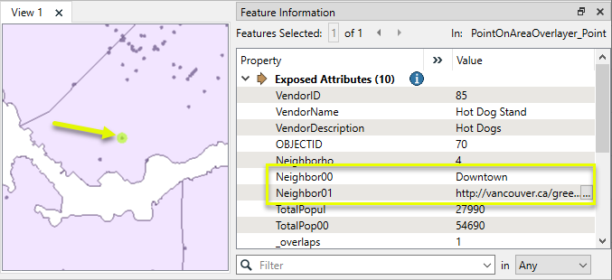

Looking at the food vendor points output, we can see that the containing neighborhood attributes have been added.

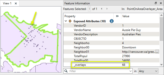

Looking at the area output, the _overlaps attribute tells us how many food vendors exist in each neighborhood.

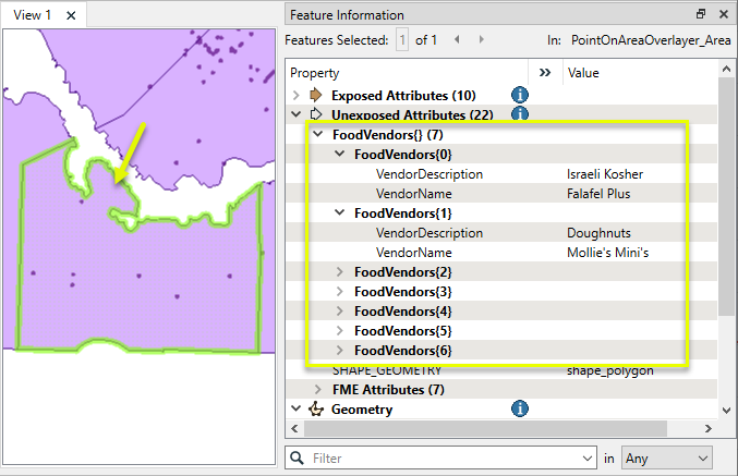

Using the same food vendor points and neighborhood polygons as the previous example, we can also build a list attribute that contains all of the food vendors for a given neighborhood.

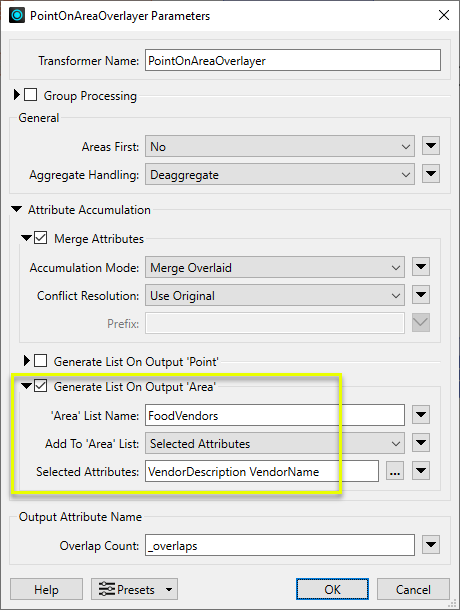

In the parameters dialog, enable Generate List on Output ‘Area’ , give the list a name, and select the attributes to be included.
Inspecting the output, we can see that the Fairview neighborhood contains 7 food vendors, and the names and descriptions of those vendors are contained in a list attribute.
