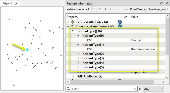

In this example, we start with a single point dataset of reported crimes, over many years. The points are routed into the Point input port of the PointOnPointOverlayer.
There are two tasks we want to accomplish.

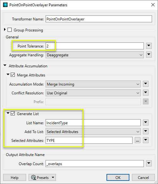

First, we want to count how many crimes were reported at any given location within the dataset. The Overlap Count attribute will tell us how many other points were found within 2 meters of the location (as defined in the Point Tolerance parameter, with the data in a UTM projection, ground units in meters).
Second, we will build a list attribute that contains the type of each report in the location. We enable Generate List, and add the Selected Attribute TYPE to a list named IncidentType.
The points are output with no changes to their geometry, but with new attributes added. The example point selected now has an _overlaps value of 6, indicating that six points (crime reports) in total are at this location.
The IncidentType list collects the Type attribute from each of the matching points.

Point Tolerance |
Each input point has the attributes from any other point within the Point Tolerance distance merged onto it. |

Generate List
When enabled, adds a list attribute to the Point output features, and the attributes of matching points are added to that feature’s list.
List Name |
Enter a name for the list attribute. Note List attributes are not accessible from the output schema in FME Workbench until they are exposed with an AttributeExposer or processed with a transformer that operates on them, such as a ListExploder or ListConcatenator.
Add To List |
All Attributes: All attributes will be added to the output Point features. Selected Attributes: Enables the Selected Attributes parameter, where specific attributes may be chosen for inclusion. |
Selected Attributes |
Enabled when Add To List is set to Selected Attributes. Specify the attributes you wish to be included. |
