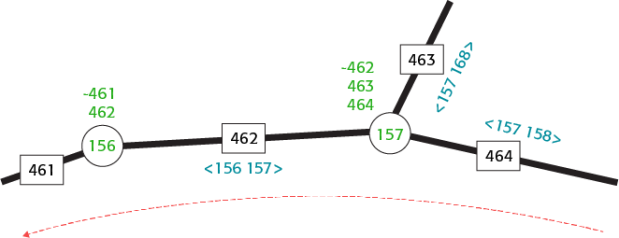

The TopologyBuilder computes topology on input point, line, and/or area features.
Topologically significant nodes and lines are computed using all input features and output with additional attributes which describe the topological relationships. The TopologyBuilder will intersect the inputs before building topology, provided the Generate From advanced parameter is set to End Nodes and Intersections. It takes any data and constructs the resulting topology after computing any intersections present in the input data.
It outputs the significant Nodes (points) and Edges (lines) with attributes describing their topological relationships. Faces (areas) may be output with information about the Edges which form them.
This transformer is typically used to determine topological relationships to aid in decision making in later transformers.
* Red line indicates direction of flow.

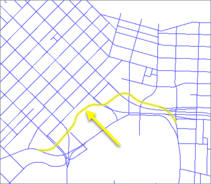

In this example, we start with a set of whole street centerlines, which are not split into individual features at intersections.

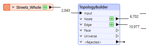

The features are routed into a TopologyBuilder.
The default parameter settings will produce correct and useful results. It is worth noting that the default setting of Generate From is left as End Nodes and Intersections, and so will create intersections where lines cross.

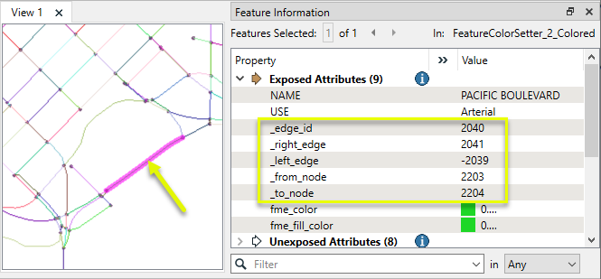

At intersections, the lines are split and nodes are created.
The Edges (line segments) also receive attributes about their relationship with adjacent features.
Note these results have been randomly colored to illustrate discrete features.

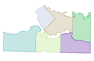

In this example, we compute topology on a set of neighborhood polygons.

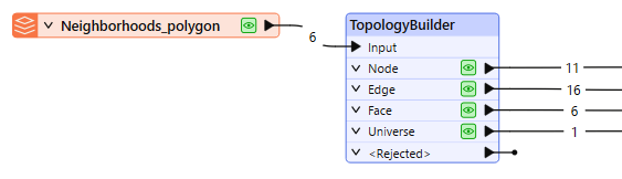

The polygons are routed into a TopologyBuilder.

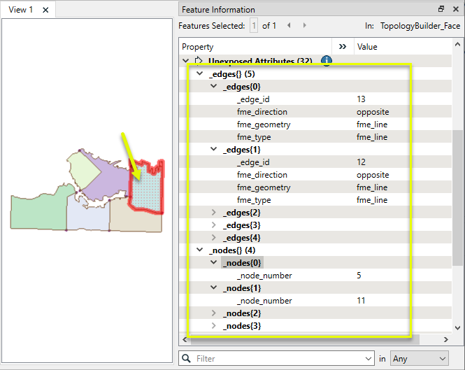

Edges and topologically significant nodes are added, and list attributes created containing topological relationship information, as shown for this selected Face (polygon).

If Generate List From Input Edges is enabled, a list attribute describing the topological relationship of each edge connected to the node is added. The edges in this list are ordered counterclockwise. |
<_edgeslistname>{}.fme_arc_id |
The ID of the edge connected to this node. The magnitude of the ID corresponds to the _edge_id of the connected edge. If the ID is positive, the start of the edge is connected to the node. If the ID is negative, the end of the edge is connected to the node. |

_right_edge |
The _edge_id of the edge that is found when traveling along this edge and turning right at the _to_node. If the ID is positive, the right edge is going away from the _to_node. If the ID is negative, the right edge is coming towards the _to_node. |
| _left_edge | The _edge_id of the edge that is found when traveling backwards along this edge and turning right at the _from_node. If the ID is positive, the left edge is going away from the _from_node. If the ID is negative, the left edge is coming towards the _from_node. |
| _from_node | The _node_number of the node at the start of this edge. |
| _to_node | The _node_number of the node at the end of this edge. |
