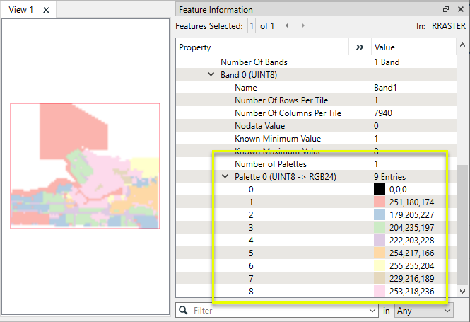

In this example, we have a single-band raster with one RGB palette, and want to resolve the palette values.

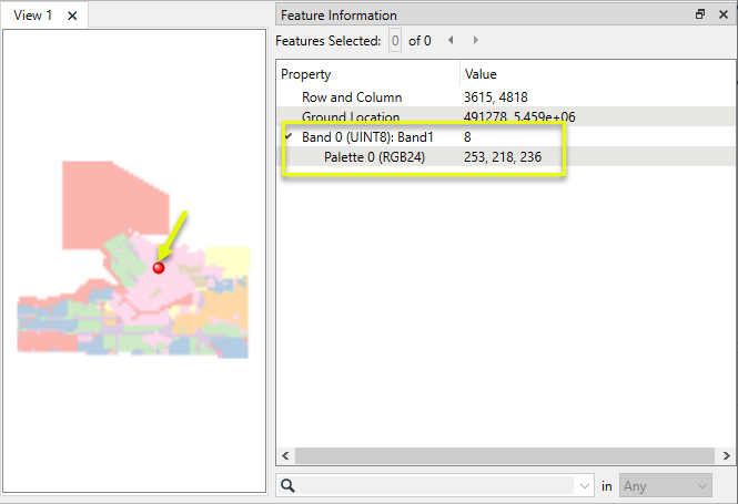

Note that the cell selected below has a value of 8, which points to the RGB palette value 253,218,236.

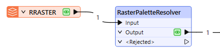

The raster is routed into a RasterPaletteResolver.
There are no parameters to be configured.

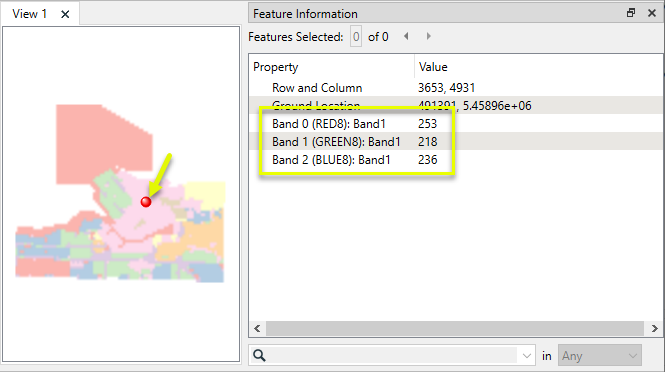

The output raster feature has three bands - red, green, and blue - and no palettes. Note that the new bands have retained the raster’s original Nodata Value, which may need to be removed in a subsequent step.
The cell value, previously 8, has been replaced with the palette component values assigned to the appropriate bands.
