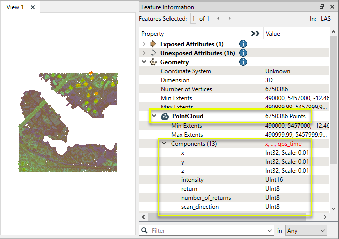

In this example, we will convert a point cloud feature into individual points for further processing. Note that the original point cloud has over six million points, and thirteen components - some of which we want to keep.

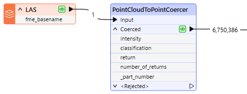

The point cloud is routed into a PointCloudToPointCoercer.

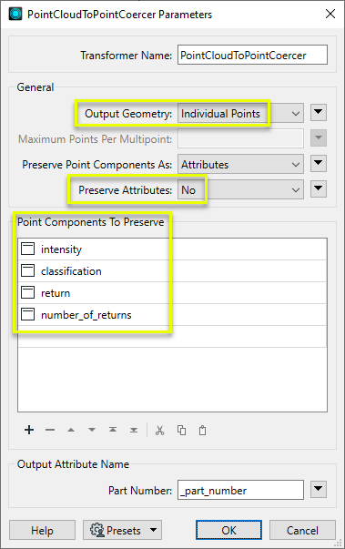

In the parameters dialog, we set Output Geometry to Individual Points and select some Point Components to Preserve. Note that these will be stored as attributes.
Preserve Attributes is set to No, as the attributes this refers to are those that apply to the entire point cloud feature, and not the individual points. We do not need them.

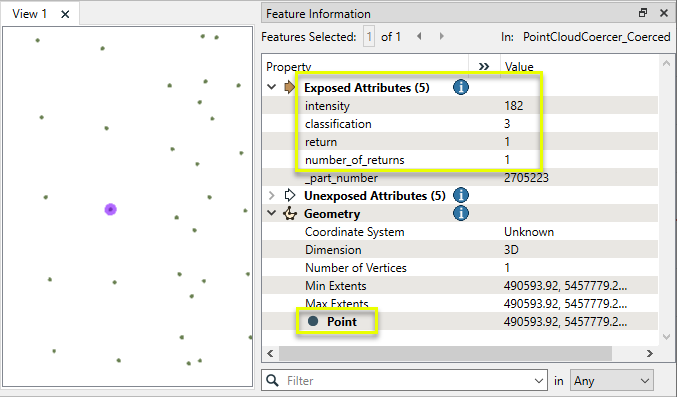

The output consists of the expected 6,750,386 individual point geometries, viewed here zoomed in closely in the FME Data Inspector. Note that the geometry type has changed to point; the x, y, and z coordinates have been retained; and the requested components and values are attributes.
