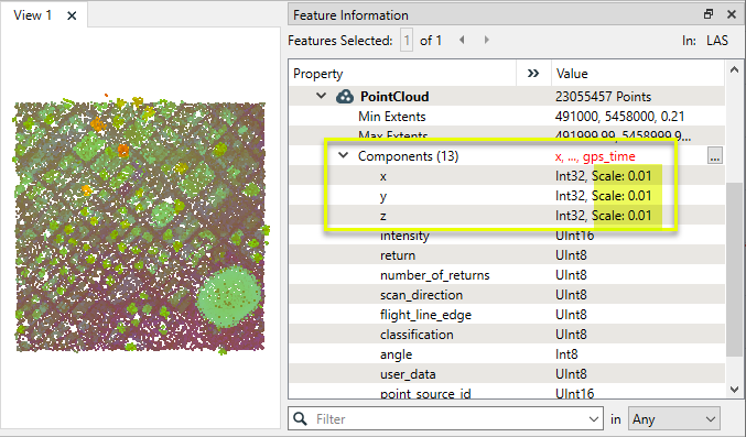

Scale is the first transformation we will look at, and it already exists on the input point cloud feature. LAS uses integers to store the x, y, and z components, with a Scale applied to indicate floating-point values with a specified number of decimal places. Note that a Scale value of 0.01 exists for each of those components.

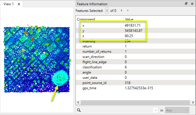

If we examine the component values of a single point in the point cloud, we can see how the Scale of 0.01 is interpreted to show coordinates with two decimal places.
Those values are still stored as integers, but are displayed as floating-point due to the Scale transformation.

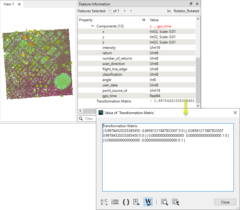

Examining the point cloud as it exits the Rotator, note the newly added Transformation Matrix. Like the Scale transformation, this does not re-calculate the component values - it just describes how they are to be manipulated.

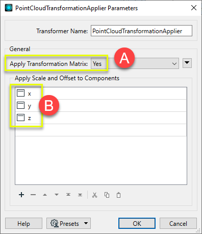

The point cloud is next routed into a PointCloudTransformationApplier. In the parameters dialog, two selections are made.
Apply Transformation Matrix (A) is set to Yes, and so the newly added Transformation Matrix will be applied, recalculating the x, y, and z components to reflect the rotation, and then removing the matrix.
The Apply Scale and Offset to Components list (B) includes the x, y, and z components, and so their Scale transformations will be applied, converting their component types from Int32 to Real64 floating-point components.

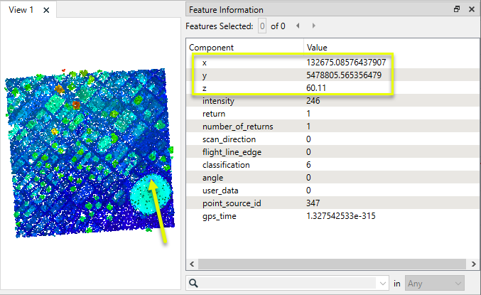

The result is a rotated point cloud, with floating-point x, y, and z components, and no Transformation Matrix.
Examining a single point in the point cloud, note the effect of recalculating the component values. The increased number of decimal places is a result of the rotation.
