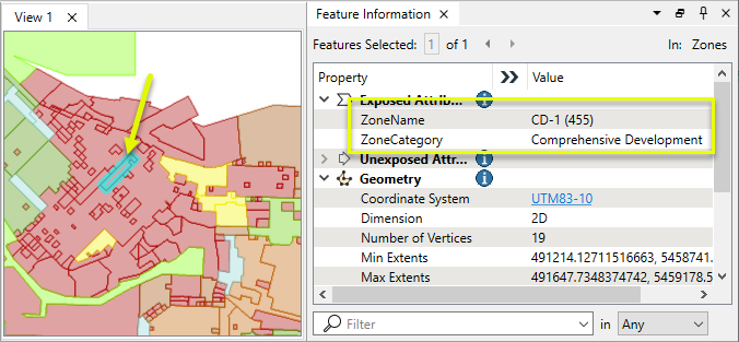

In this example, we have a set polygons representing zoning. They are color-coded by the Zone Category. There are multiple Zone Names within each category.
We want to combine the areas by category, generalizing the areas.

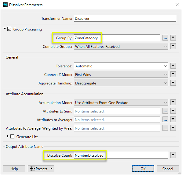

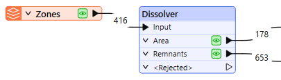

The features are routed into a Dissolver.
In the parameters dialog, Group By is set to ZoneCategory, so that each category will be evaluated for dissolving separately.

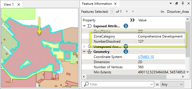

The Dissolve Count output attribute is given a name.
Areas have been dissolved according to category. Note the NumberDissolved attribute containing the count of polygons that went into the output area.
The remnants are also output.
