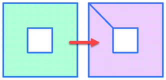

Adds internal edges to connect donut holes to the outer shell, producing a non-donut polygon.
- Preparing donut geometries for formats that do not have donut support
The DonutBridgeBuilder receives donut polygons and connects all holes to the exterior shell with one continuous interior line. The result is a single non-donut polygon.
The connections between holes and the outer shell generally consist of duplicate segments in opposing directions (cycles).

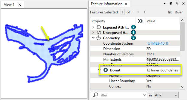

In this example, we have a donut polygon representing a portion of a major river. Note there are a number of holes, each one an island.
We want to store this in a format that does not support donuts, but want to keep the boundaries of the holes intact.

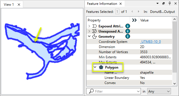

The feature is routed into a DonutBridgeBuilder.
This transformer has no parameters to set.
A single polygon is output, with interior edges connecting all of the holes.

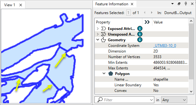

Looking closer, we can see a number of connections between holes, as well as the point where the line connects to the outer shell.
