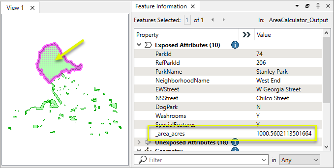

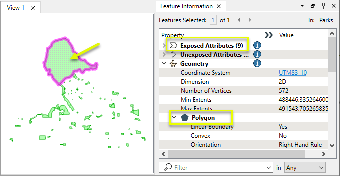

In this example, we have a set of park polygons and want to extract the area of each feature in acres. Note that the coordinate system is UTM-83, with ground units in meters.
The features are routed into an AreaCalculator.

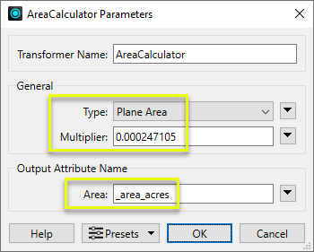

In the parameters dialog, Multiplier is set to the square meters to acres conversion factor, and the new attribute name _area is modified to _area_acres to remind us of the unit conversion.
The output features have a new _area_acres attribute, containing the area values.
