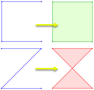

No checking is performed on the output geometry, and self-intersecting polygons can be created.

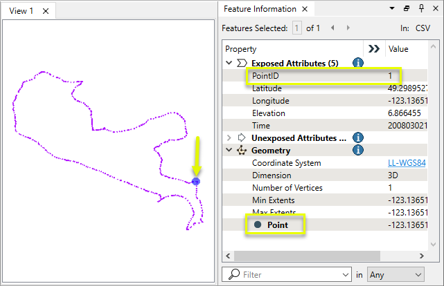

In this example, we have a series of GPS points along a route surrounding an area. We want to build a polygon of the area.
The points are ordered by their PointID attribute. We need to connect the points to create linear geometry.

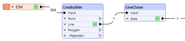

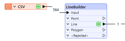

The points are routed into a LineBuilder.

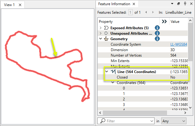

The output geometry connects the input points, but has not created a closed polygon.
The last GPS point is not in the same position as the first.
The line is routed into a LineCloser.

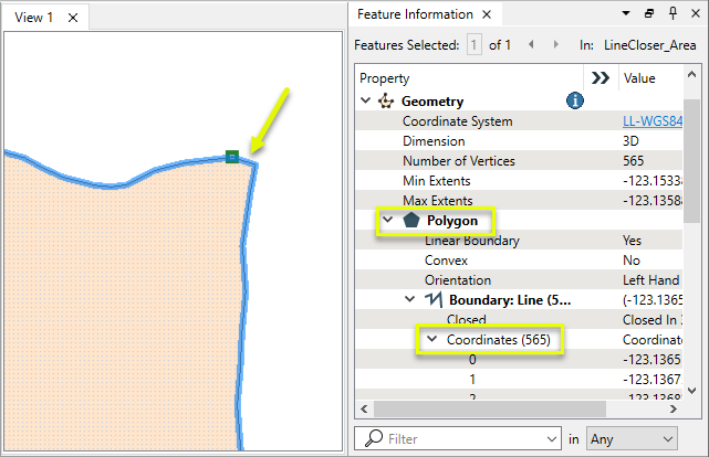

An additional point is added to the line, in the same position as the first, and the area is closed. Note the Coordinates count has increased by 1.

Use the GeometryValidator to check for self-intersecting geometry after using the LineCloser.
