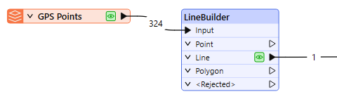

In this example, we have a set of point features captured by GPS along a route. We want to create a line from these sequential points.
The features are routed into a LineBuilder.

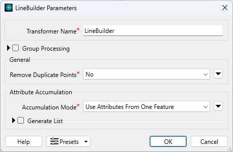

In the parameters dialog, the default settings are used.

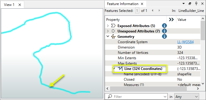

A single line feature is output, connecting all of the input points in the order they were received.
