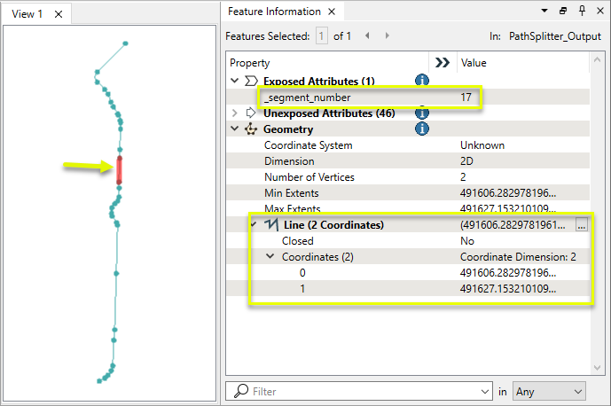

In this example, we have a path feature representing a transit line. The path is made up of numerous arc and short line segments.
We want to split this path into its component parts.
The feature is routed into a PathSplitter.

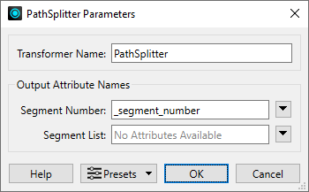

In the parameters dialog, the default settings are kept. Note that the Segment List parameter is not available, as the input feature has no list attribute on it.
One feature is output for each path segment, with a new attribute containing the segment number.

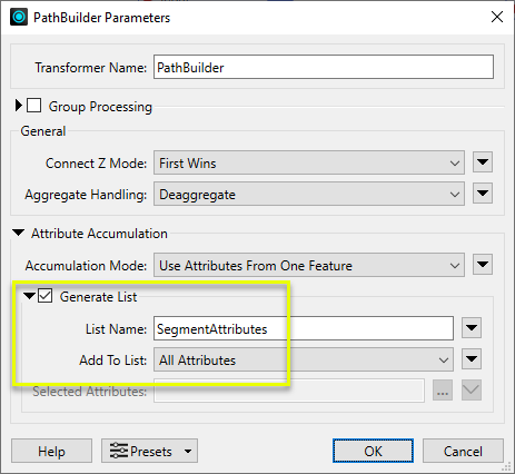

Creating a path and preserving attributes
In this example, we have a set of short lines that make up a bike path. The attribute values can vary from segment to segment.
We want to treat the bike path as a single piece of geometry, but retain the original segment details - both geometry and attribution.
The lines are routed into a PathBuilder.

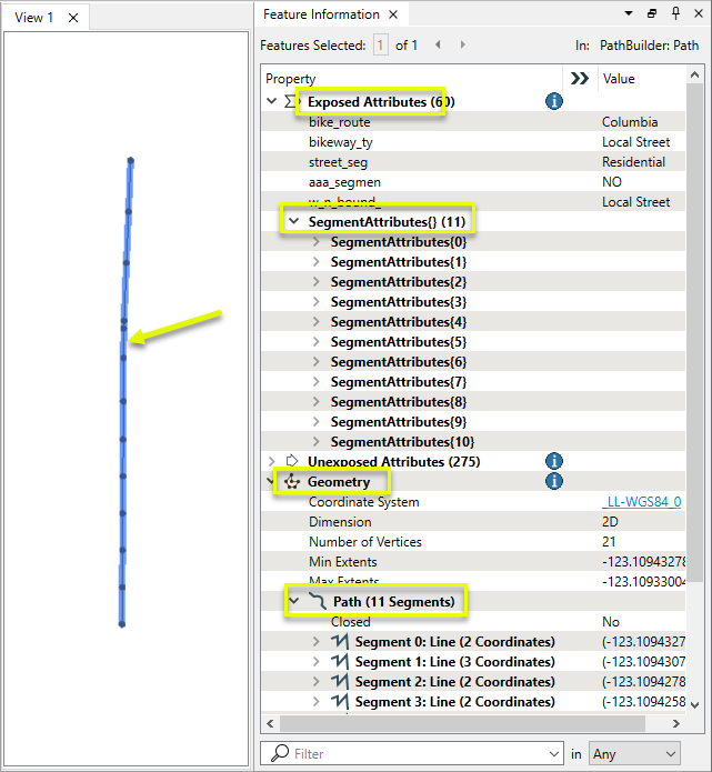

In the parameters dialog, Generate List is enabled, the list is named SegmentAttributes, and All Attributes are added to list.
The output path has a SegmentAttributes list with 11 list items, and its geometry is a Path with 11 segments.
Note the difference between the attribute values on list items 9 and 10.

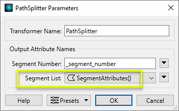

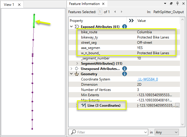

Splitting a path and recovering attributes
In this example, we want to recover the original geometry and attribution from the path with a list attribute created in the example above.
Note the path geometry with 11 segments and the SegmentAttributes list with 11 items.
The path is routed into a PathSplitter.
In the parameters dialog, Segment List is set to the list attribute SegmentAttributes.
The output features receive attribute values according to path segment and list item pairs.
