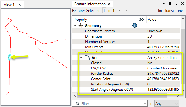

In this example, we have some transit lines which are composed of lines and arcs. We will stroke the arcs using different settings and examine the results.
The features are in a UTM coordinate system with ground units in meters.
The features are routed into an ArcStroker.

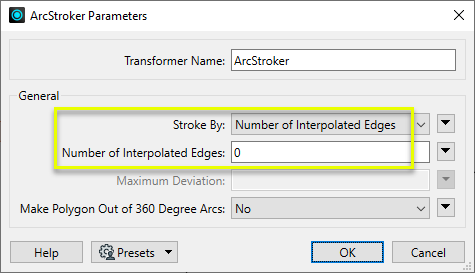

Default: ArcStroker chooses a reasonable number of edges
In the parameters dialog, the default settings of zero (0) interpolated edges are kept. The transformer will calculate a reasonable value.
The output feature, shown in blue over the original arc in yellow, is a line with 23 coordinates. Note that it tightly follows the original arc, and coordinate 4 is highlighted.
The line segments to either side of the arc have been passed through unchanged.

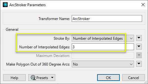

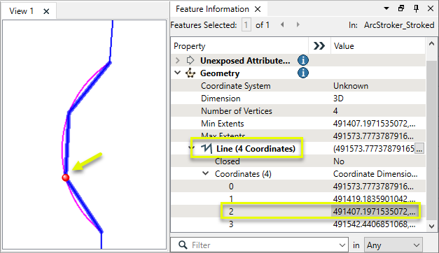

Specifying an exact number of edges
In the parameters dialog, the number of interpolated edges is set to 3.
The output feature, shown in blue with the original arc in magenta, is a line with three segments (and so four coordinates).
It visibly deviates from the original arc, but has few points and so will optimize storage and processing.

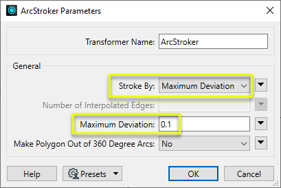

Specifying Maximum Deviation to tightly follow an arc
In the parameters dialog, Stroke By is set to Maximum Deviation, with a value of 0.1 meters. This will prevent stroked segments from being positioned more than 10 centimeters away from the original arc.
The output feature, shown in blue over the original arc in yellow, is a line with 44 coordinates. Coordinate 3 is highlighted.
This feature follows the original arc even more tightly than the default setting, producing nearly double the number of interpolated points.
Maximum deviation is a measurement in ground units. Features with a geographic (lat/long) coordinate system may need to be reprojected before using this option.
