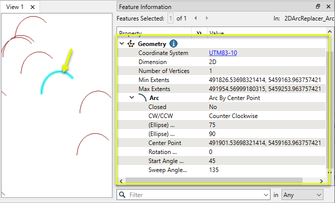

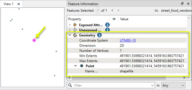

In this example, we have a set of points and want to replace them with arcs.

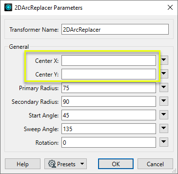

The features are routed into a 2DArcReplacer.
In the parameters dialog, values are entered for radii and angles, but the Center X and Y parameters are left blank.
The points have been replaced by arcs as specified.
