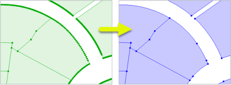

In this example, we have a set of parcel polygons. Note that the curved boundaries have been stroked at some point, and are composed of many small line segments. We want to restore them to arc geometry.
The features are routed into a CurveFitter.
In the parameters dialog, Precision is set to 0.2 meters, with Flattening at 10% of that value.
Weighting is slightly adjusted - Accuracy Weight is increased to the maximum value of 10, emphasizing positional accuracy over smoothness and compression.
Preserved Shared Boundaries is set to Yes, to avoid creating gaps or overlaps where parcel boundaries touch.
The output feature boundaries are paths composed of line segments and arcs.

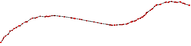

In this example, we have a line with 85 straight segments, representing an engineered feature such as a road. The feature was likely originally defined by arcs and lines.
Since roads are usually engineered as a series of tangent segments, our goal is to produce smooth and positionally accurate geometry (as opposed to reducing points for compression).

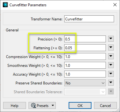

In the parameters dialog, Precision is set to a first best guess of 0.5 meters with Flattening at 10% of the Precision value - 0.05.
The Weighting parameters (Compression, Smoothness, and Accuracy) are left with their default balanced values of 1.0.

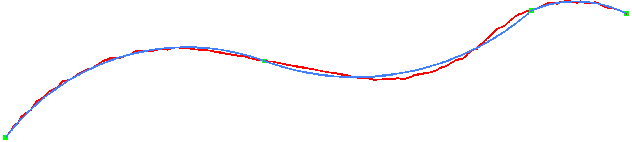

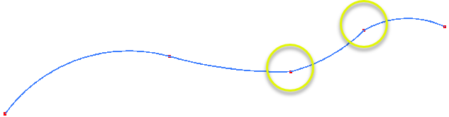

The output feature is a path composed of three arcs. Note that the left and center segments have a fairly smooth transition, but the center and right segments are visibly not tangent.

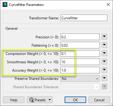

To further refine the output geometry, we will adjust the weighting parameters - Compression, Smoothness, and Accuracy. By default, they are equally balanced. We will tune them towards our desired outcome (smooth and accurate), with less emphasis on point reduction (compression).
Compression Weight is reduced to 0.1, while Smoothness Weight is increased to its maximum value of 10.
Accuracy Weight remains at 1.0, and the Precision value still keeps the geometry within 0.2 meters of its original location.
The resulting path is nearly perfectly smooth and still accurate to within 0.2 meters.
