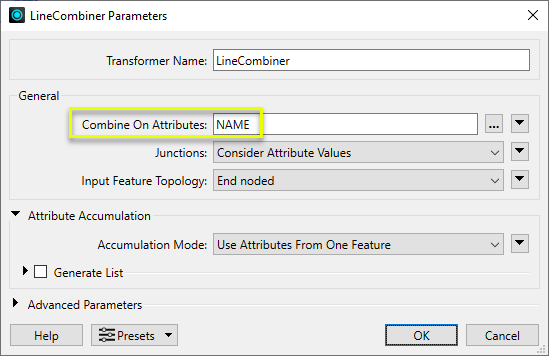

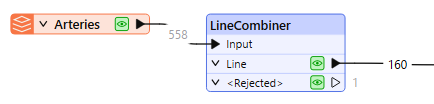

In this example, we have a set of streets that have been split at all intersections, producing multiple individual lines for each street. We want to reconstruct the original whole streets.
Note that the features have a NAME attribute, which will be used to combine them.
The features are routed into a LineCombiner.
In the parameter dialog, Combine On Attributes is set to NAME.

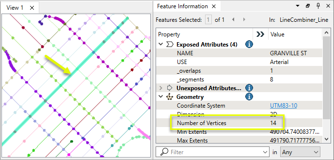

The output features are continuous lines.
