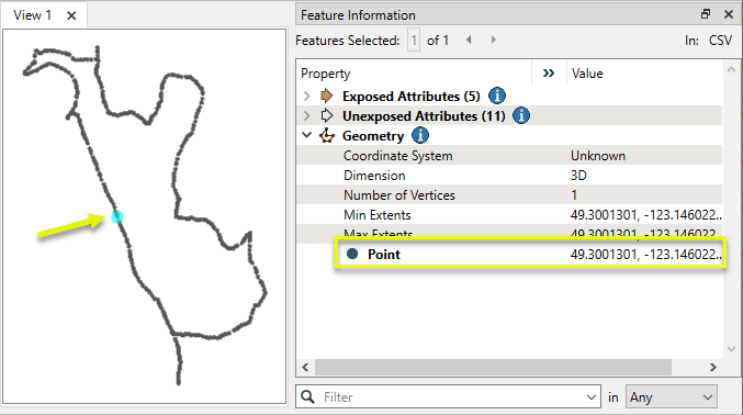

In this example, we have a set of GPS points in which the x and y coordinates have been incorrectly designated. Examining one point, we see that x appears to be a latitude value and y a longitude value - they should be the reverse.

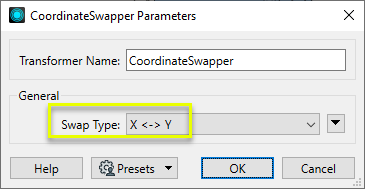

The points are routed into a CoordinateSwapper.
In the parameters dialog, Swap Type is set to X <-> Y.

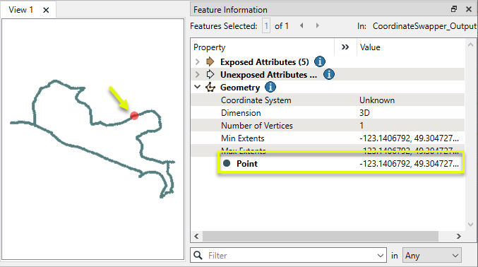

The output features have their x and y coordinates corrected.
