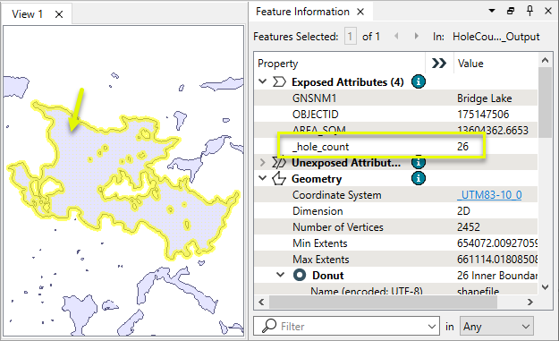

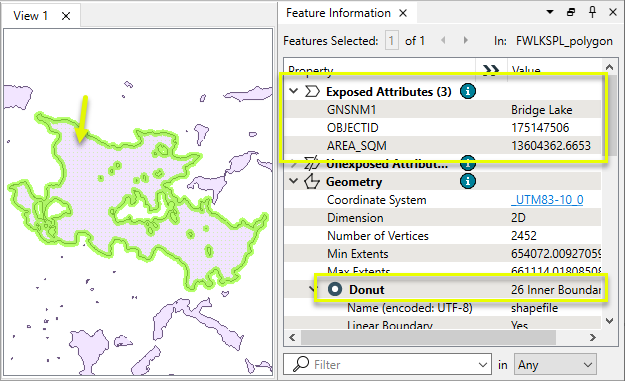

In this example, we have a dataset of lakes and want to know the number of islands in each one.
Note that the number of holes in a donut polygon is stored as a geometry property, but is not readily accessible.
The features are routed into a HoleCounter.

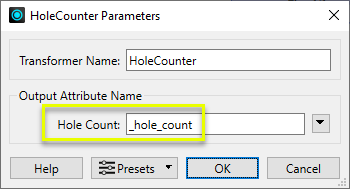

In the parameters dialog, the default name is kept for the Hole Count attribute.
The number of holes is added as an attribute value.
Non-donut polygons receive a count of zero (0).

Hole Count |
Name the attribute to contain the number of holes in the feature. |
