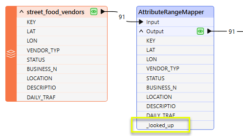

In this example, we want to classify food vendors by the amount of daily traffic they have. The features are routed into an AttributeRangeFilter.

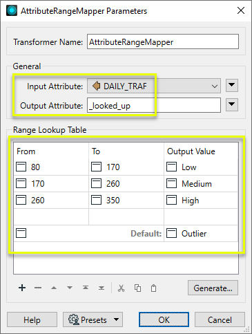

In the parameters dialog, we use the Generate… option to calculate three equal-interval ranges, based on our knowledge of the upper and lower limits of the daily traffic attribute values.
The intervals are calculated and added to the Range Lookup Table, with related Output Values automatically named. Note we have also selected the DAILY_TRAF attribute as our Source Attribute for categorization, and the new Output Attribute to be added to the features keeps the default name of _looked_up.
Lastly, we will overwrite the auto-generated Output Value names with meaningful names, and assign a Default name for any features that may not fall within our defined ranges.

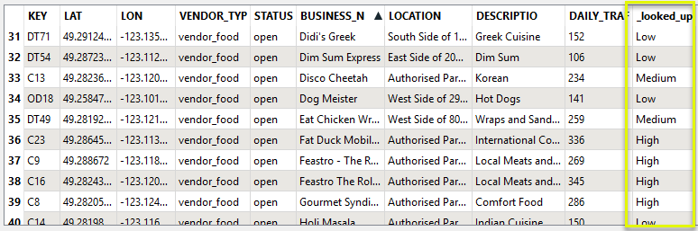

The output features now have an additional attribute, containing the range name they fall within.
