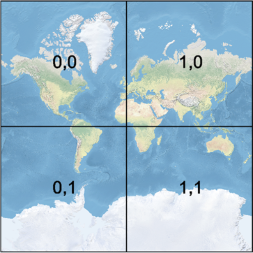

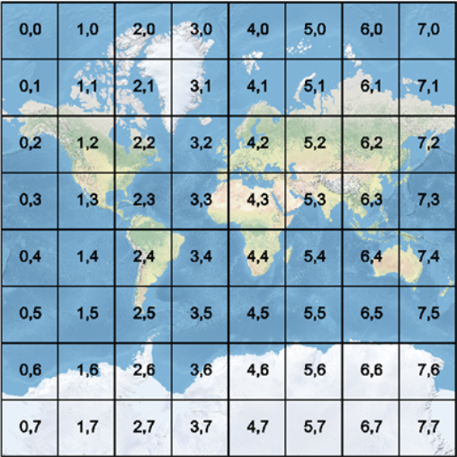

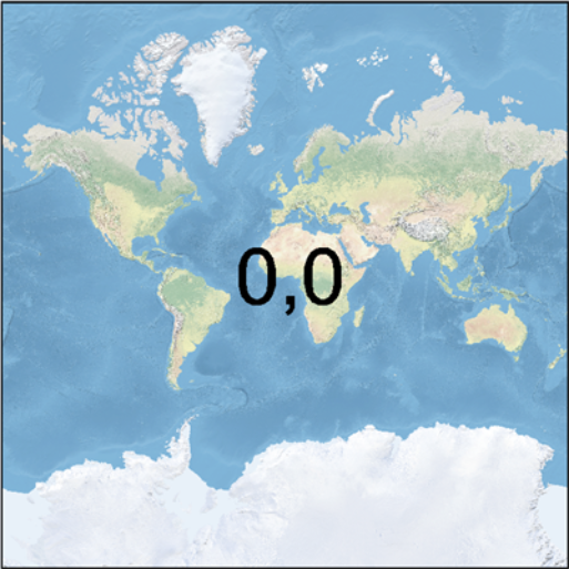

At level 0, the entire world is represented by a 256x256 pixel tile. Each level increases the number of rows and columns by a factor of two: level 1 is 512x512, level 2 is 1024x1024, and so on. The number of tiles is increased accordingly - 1 tile, 4 tiles, 16 tiles, and so on. GoogleMapsCompatible zoom level 0 tiles (column, row):
GoogleMapsCompatible zoom level 1 tiles:
GoogleMapsCompatible zoom level 3 tiles:

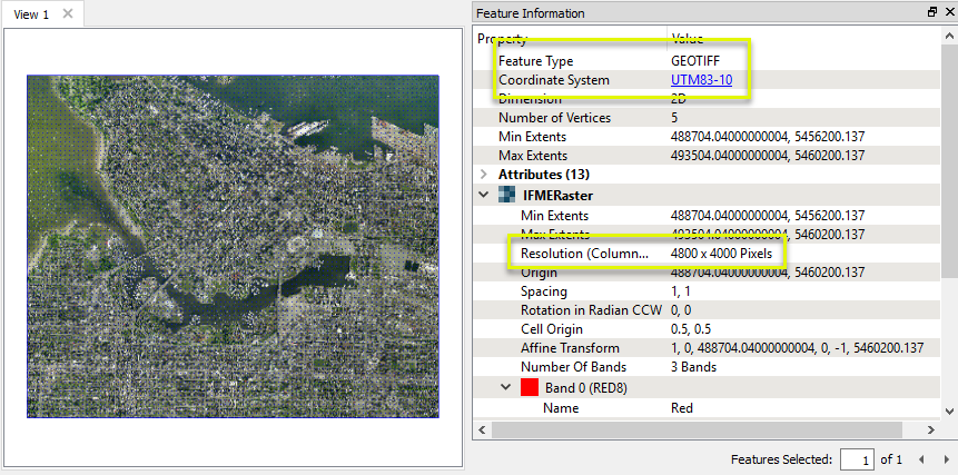

In this example, we prepare a single 4800 x 4000 orthophoto of Vancouver (at 1 meter resolution) for use in Google Maps. The source image is a single GeoTIFF. Note that the projection is UTM83-10 - the transformer will need to reproject it before resampling and tiling.
The raster is routed into a WebMapTiler.

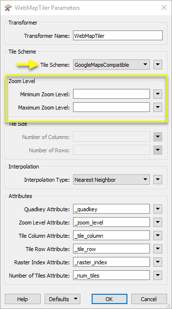

In the parameters dialog, we choose GoogleMapsCompatible as our Tile Scheme.
Note that the Zoom Levels have been left blank. The transformer will calculate the appropriate minimum and maximum levels that can be produced from the input raster.
The zoom levels, as well as the size and position of the tiles for each level, are fixed by Google Maps. The WebMapTiler will adjust the output rasters to fit into these standards.

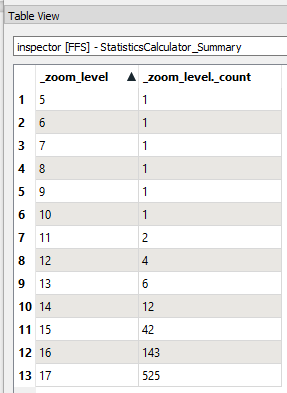

A total of 740 tiles are produced from the original. The number of tiles per zoom level can be analyzed with a StatisticsCalculator.
Note that only zoom levels 5 through 17 have been produced (out of all possible levels, from 0 - the entire earth - to 23 - the smallest possible area of coverage given the original image size and resolution).

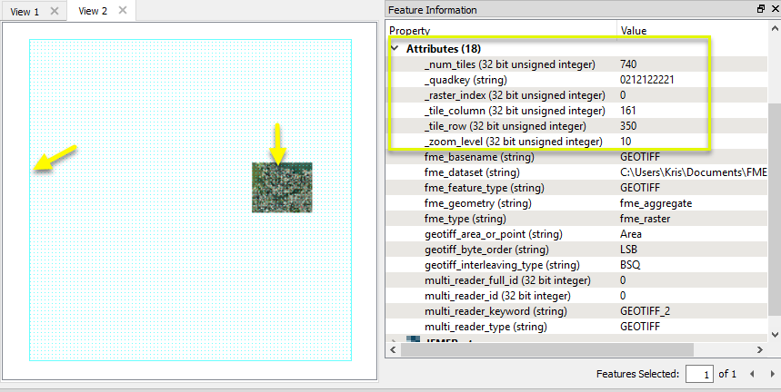

Zoom Level 10
Examining the single tile output for zoom level 10, note the new attributes added including tile position, zoom level, quadkey (used by Google Maps), and more.
The extent of the original raster falls wholly inside the extent of this standard tile’s size and position, so the raster has been padded with blank cells.

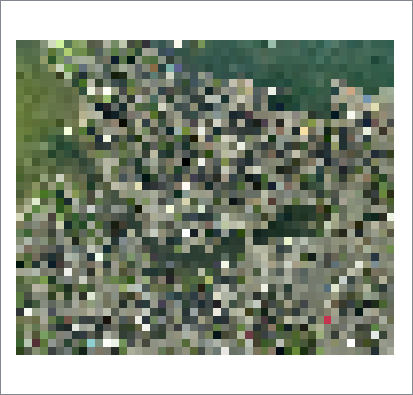

A close view of the portion of the raster containing the original shows the resampling to an appropriate (lower) resolution.

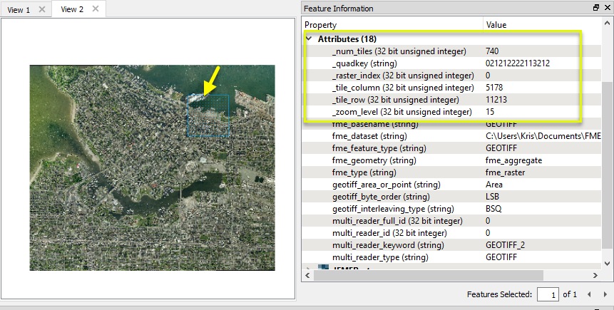

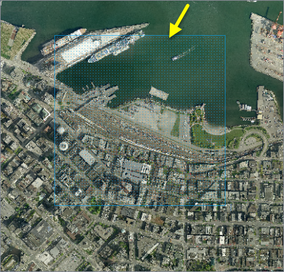

Zoom Level 15
42 tiles were produced for zoom level 15.
A closer look at the selected tile clearly shows that higher resolution is retained for higher zoom levels.
