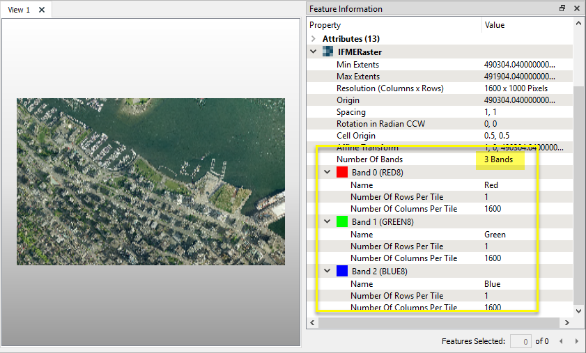

In this example, we start with an orthoimage raster. It has three bands - red, green, and blue - and we will generate a single band with a palette from those colors.
The raster is routed into a RasterPaletteGenerator.

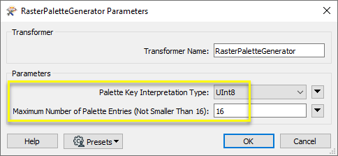

In the parameters dialog, Palette Key Interpretation Type is set to UInt8 (unsigned 8-bit integer).
UInt8 has a possible range of values of 0 to 255, and we could generate a total of 256 palette keys and color values. However, we will set the Maximum Number of Palette Entries to 16, producing the smallest palette possible.

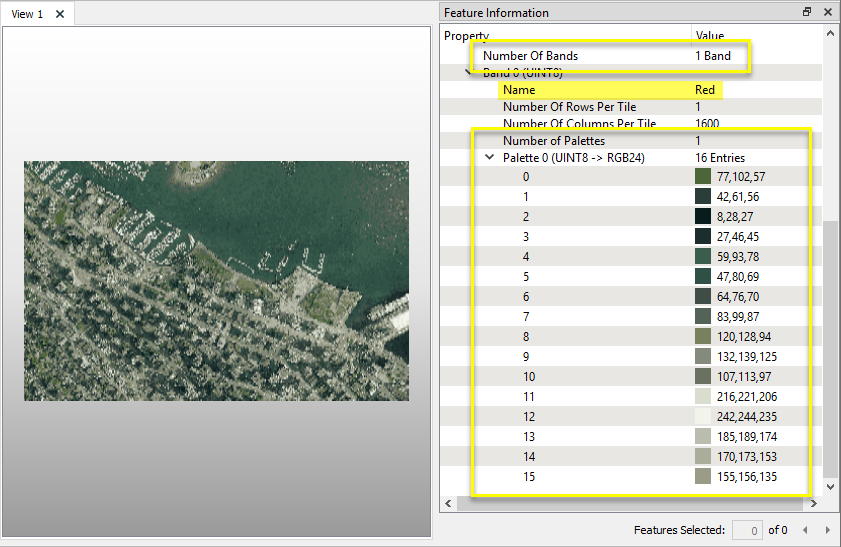

The output raster has one band, with a palette of 16 keys and associated RGB values. Note that band name of the first band (Red) has been carried forward - that could be removed with a RasterBandNameSetter if desired.
The range of colors in the original raster was not widely varied, and so this output raster looks very much like the original. If the input raster had a wider range of colors, a 16 item palette would introduce more generalization (and loss) of colors.
