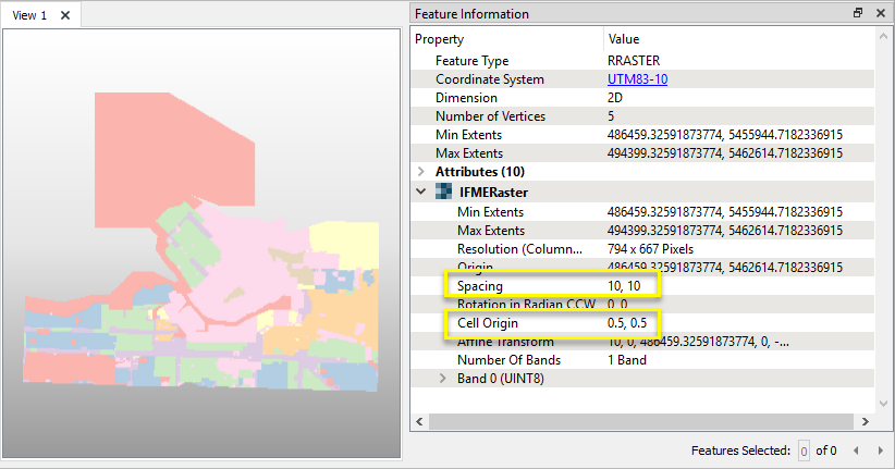

Note that the source raster has 10 x 10 meter cells (as the ground units of the coordinate system are meters), and the Cell Origin is set to 0.5,0.5 - the center of the cell.

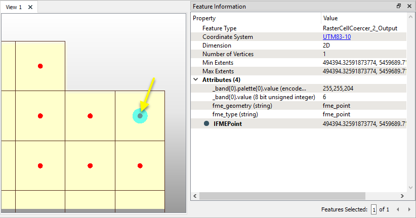

By using RasterCellCoercer transformers to produce both point and polygon geometries of the cells, we can clearly see the center position of the points. We will move them to the corner by altering the Cell Origin.

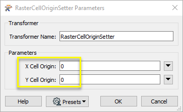

In the RasterCellOriginSetter parameters dialog, both the X and Y Cell Origin are set to zero (0).
In the RasterCellCoercer parameters dialog, Output Cell Geometry is set to Points.

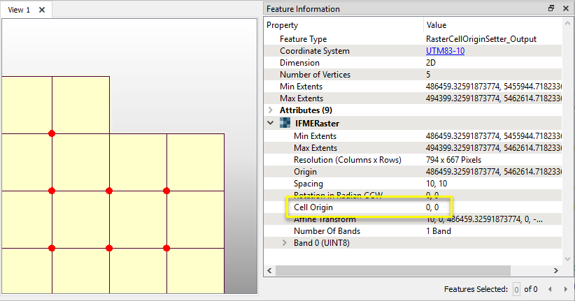

The output points, shown here in red against the output raster with its modified cell origin of 0,0, are positioned at the bottom left corner of the cell.
Note that given a cell size of 10 meters by 10 meters, the newly created point's position is approximately 7 meters away from the original cell origin.
