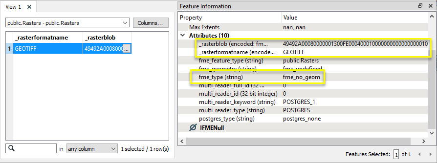

A database reader (PostgreSQL, in this case) reads the feature from the database table, which is then routed into a RasterReplacer.
Examining the feature as it exits the database reader, note that it has no geometry.
The first two attributes - _rasterblob and _rasterformatname - contain the encoded raster as a Blob, and the name of the encoding (GeoTIFF) used for the raster. Both of these attributes were originally created by the RasterExtractor.

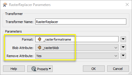

In the RasterReplacer’s parameters dialog, Format is set to read the contents of the _rasterformatname attribute. We could alternatively set it explicitly to GeoTIFF, if we did not have an attribute providing that information.
Blob Attribute is set to _rasterblob, and Remove Attribute is set to Yes, which will remove the Blob attribute once it has been decoded and set as the feature’s geometry.

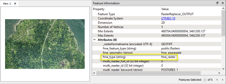

The output feature now has raster geometry, and the Blob attribute has been removed.
