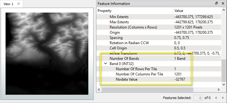

In this example, we will add a band name to a DEM raster. Note that the original raster feature has a single band, with no band name.

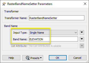

The raster is routed into a RasterBandNameSetter. The default state of the raster is “all bands selected,” so this raster’s single band is currently selected and will be acted on by the transformer.
In the parameters dialog, Input Type is set to Single Name, and the Band Name specified is ELEVATION.

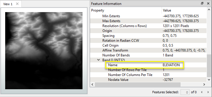

The output raster feature now has a band name, ELEVATION.
